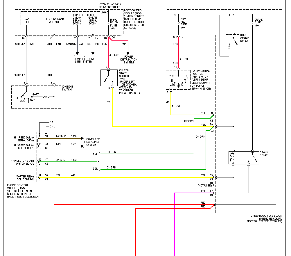

The starter grounds to the block which grounds on the rad support. The 2 large the 2 large wires on the starter go to the alternator and the fuse box. The purple wire comes from the starter relay.
So you are basically not getting a signal from the crank relay. That is in the fuse box;
Places to look 2 fuses 2 relays(if its an auto), Also the park/neutral switch.
Block grounds to chassis these days.
The cut off wires are L to R
Battery Starter Solenoid

I'm thinking the run/crank fuses & relays, because the PS also depends on them.
