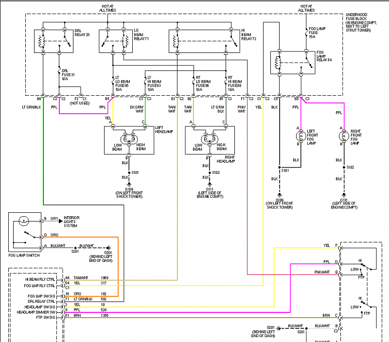

Posts: 26,539
The clockspring doesn't have anything to do with the high beam switch
If somebody screwed with the connection to the stalk, I'm not sure that would interfere with only the high beams.
This might help, looks to me like the relay is the culprit.
