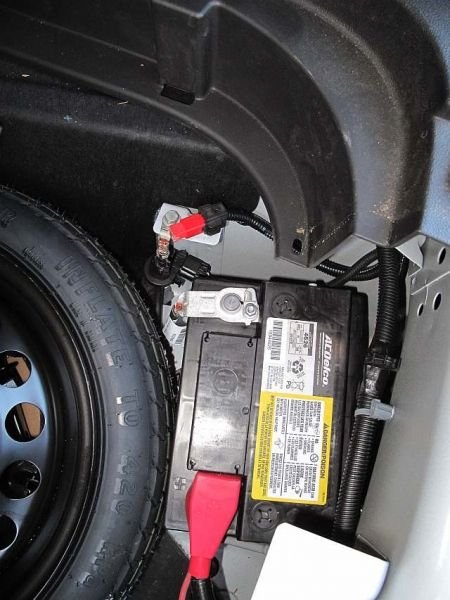

Did you check the maxi fuse next to the ground lug near the battery?

the maxi fuse is in the back by the battery
That’s it the red piece at the top of the picture , it’s a blade fuse
