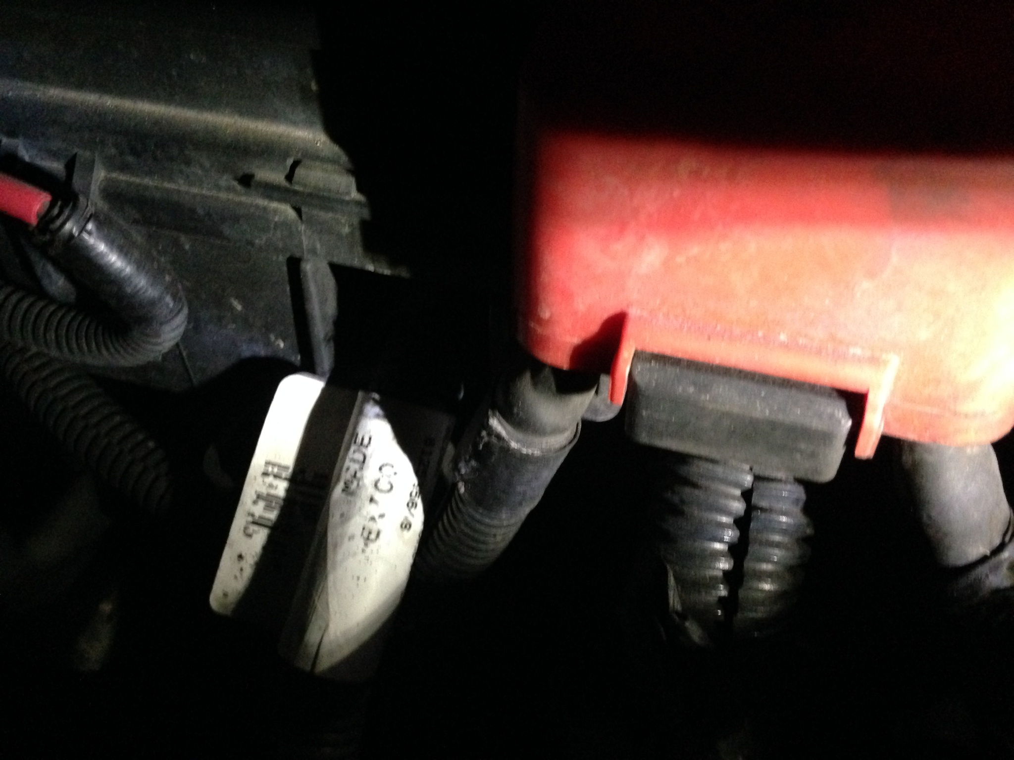

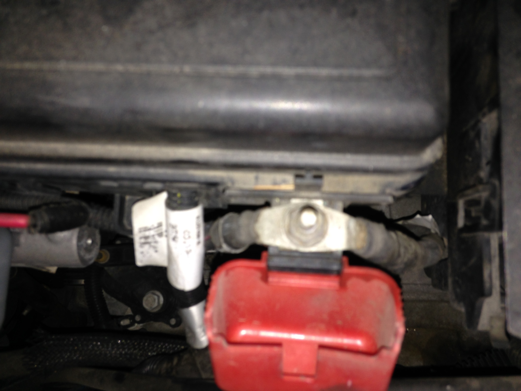

The battery to fuse box and the fuse box to starter is the terminal at the fuse nor with the red cover.
Here

Makes sense. Wire below fuse #5
