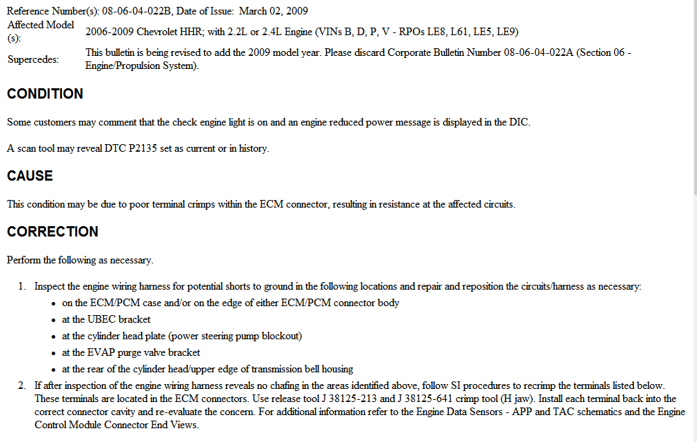

Posts: 26,482
P2135 is directly related to a frayed wire at the EVAP valve bracket.
Here is part of the TSB, there is more detail if you get the complete doc in the Official TSB thread.https://www.chevyhhr.net/forums/prob...-thread-23231/

[QUOTE=donbrew;839154]P2135 is directly related to a frayed wire at the EVAP valve bracket.
Thanks, donbrew. I'm going to check it right now.
