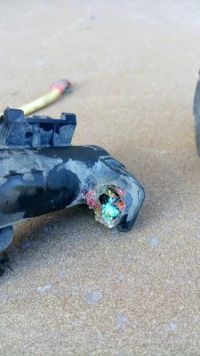

Oxygen O2 Sensor wires were damaged. The sensor has been replaced.

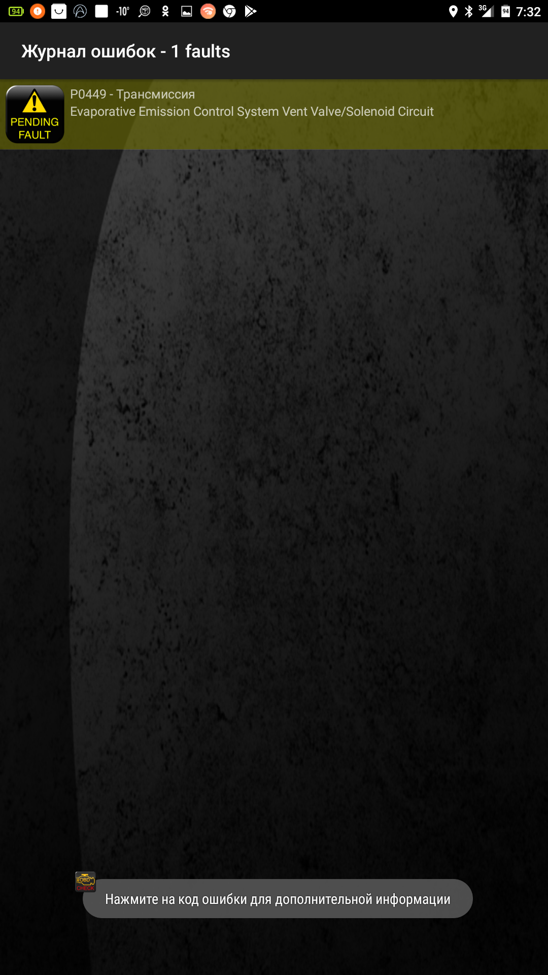

P0449
