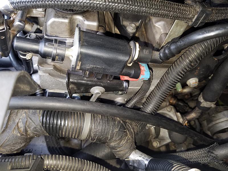

I was wondering about that, donbrew. I checked the wiring that I saw in the picture from the link you provided about the P2135 code. I didn't see anywhere on any part of any wiring that could chaff on the EVAP bracket. I attached a picture of my wiring harnesses and the EVAP bracket.
Can you give me an exact location of where all those connections come together in the harness?

The connector at the ECM.

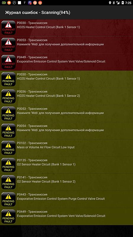

Help me,please
The muffler came off. After that, there was this

All pending faults, try a battery lobotomy, then have your battery load tested.

My guess is more than just the muffler came off, more likely a large part of the exhaust upto the catalytic converter. And you may have blown a fuse or 2 (the one labelled "emissions")
