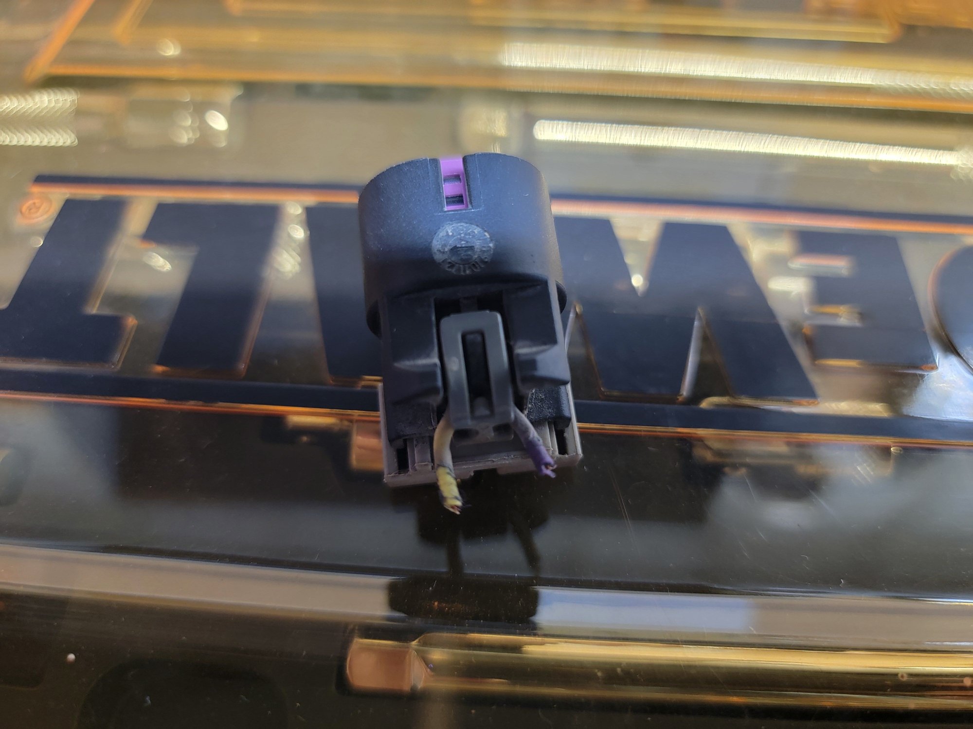

Found the problem. Speed sensor wiring was chewed through 🤬
Old Jun 15, 2024 | 08:46 PM
Posts: 26,539
Varmints 1, HHR 0.
