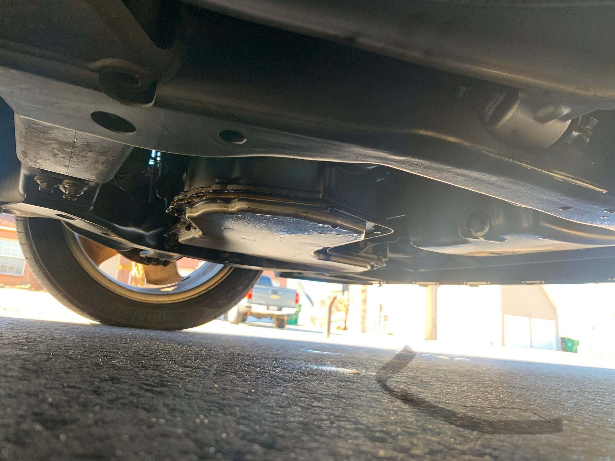

Where the arrow is, is the small oil spot. The other ones are water after defrosting

I don't see how that much oil could squirt onto the ground without getting oil on a lot of other stuff under the hood.

I don't see very much oil on the ground, in fact, I don't even see an arrow. Don's right, if the solenoid valve leaked a lot of oil out, the top of the valve cover would be quite a puddle, but it looks pretty dry.

That small spot of oil on the ground is all that's left, sorry you can't see it. The rest of the oil ran out at the place I was stopped at and then I had it towed home. There is virtually no oil left in it and it seems to have leaked underneath the pan. Dipstick is completely dry after pulling, wiping and reinserting.

There is not any evidence of a major oil leak in the picture you posted of the valve cover. If it is leaking as bad as you say, then you had better start looking elsewhere for the leak source. Based on some of the wet drips I see in the bottom side photo, it could be anything from the front crank seal to the oil pressure sending unit.
I would say top it off with oil, crank it up and look for the leak. If it leaks as bad as you say, then you should see the leak pretty quick.

Oil is not going to run out while the engine is not running from the VVT valve area. There does seem to be some drips on the trans oil pan. You should be able to follow the wet spot up to locate the leak.

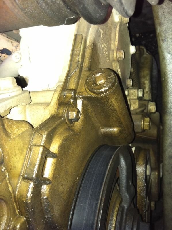

The front cover harmonic balancer seal can sling oil around pretty good.
