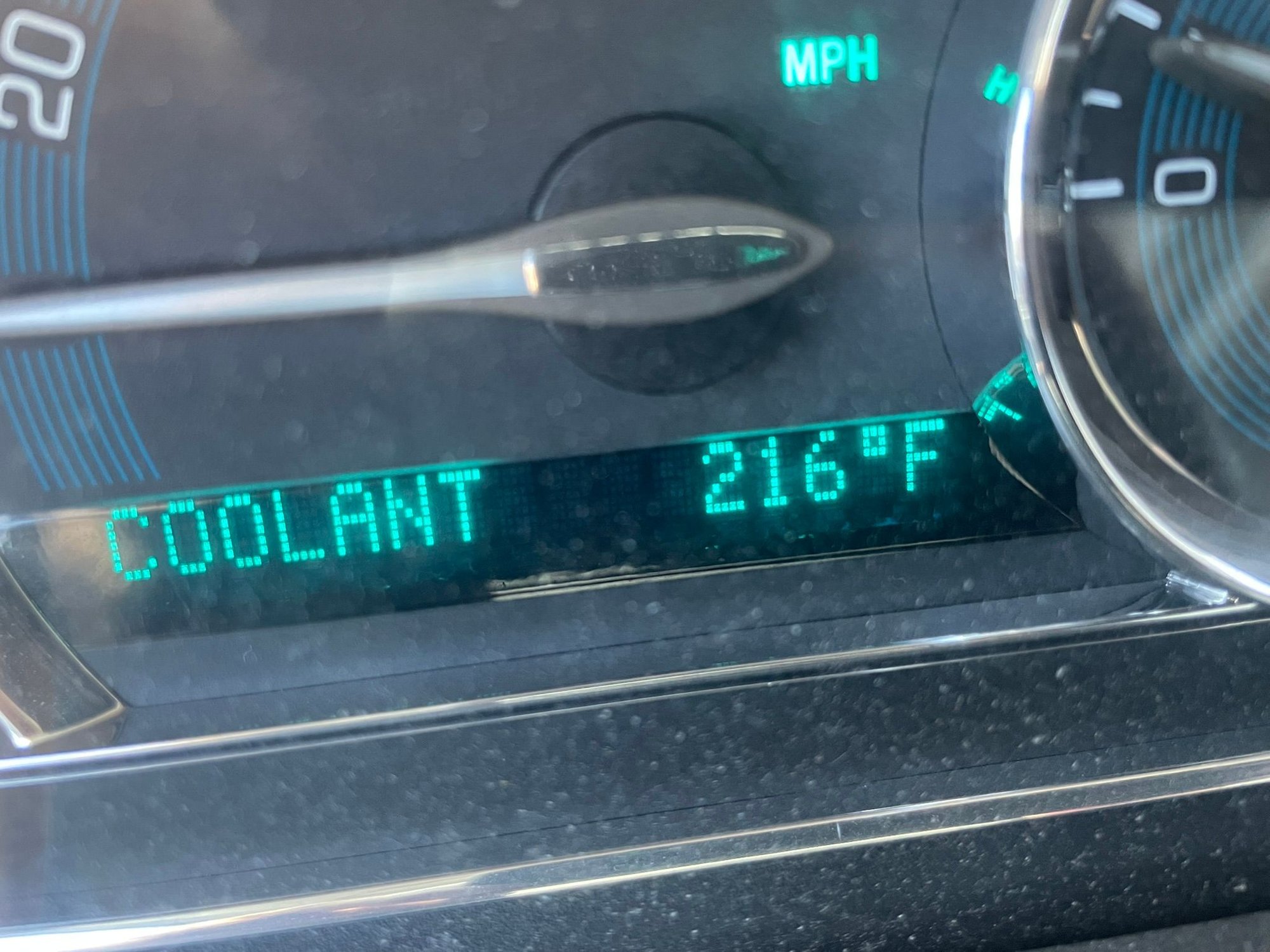

I drove on the hiway for about 20 minutes to work. Ambient temp today in Dallas is 95 degrees. Coolant temp never topped 196 on my drive until I get to the parking lot, then it started to rise to 210 almost immediately with A/C on. I pull into a parking spot at 1:46 and it was idleing at 212 degrees. I sit for a few more minutes and at 1:49 it had climbed to 216 degrees with A/C on. I popped the hood and checked that the fan was running, it was. There is no coolant leak. This is hotter than I am comfortable with. Perhaps the new coolant sensor is off a little or I just need to burp the system. My driveway is at a nice incline so it will self burp tonight as long as I keep the overflow bottle half full. I am a little confused about the P0146 and the thermostat looks and tested perfect. I hate to drop $60 for a thermostat, but if I loose A/C again I'll give it a try. And yes, the ACDelco is $59 on rockauto!!
