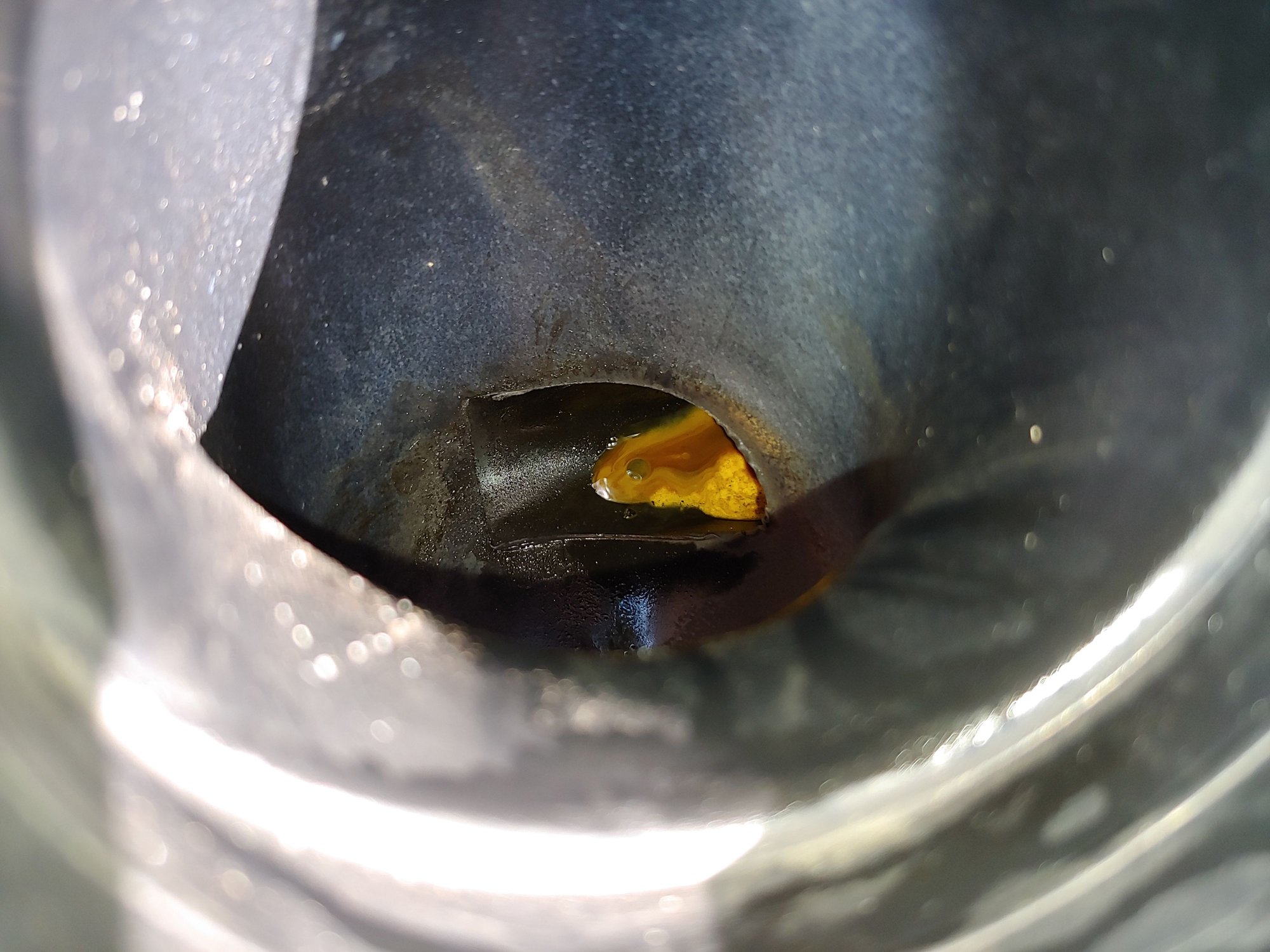

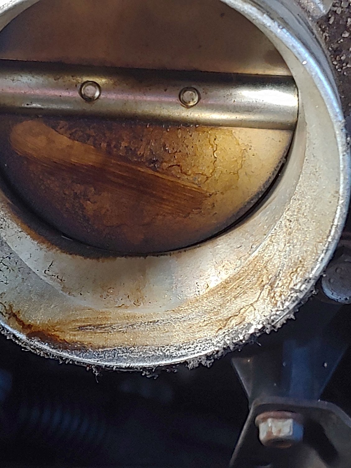

Completely irrelevant but I was cleaning the maf abd throttle body and there was A LOT of gunk! And then the intake elbow seemed to have oil/water condensation built up.
Think im going to do a thorough cleaning and while I have easy access I am going to use electronic cleaner for the ecm/tcm module and take apart the fuse box to exam pins and clean them!
Old Jan 29, 2021 | 05:43 PM
Posts: 40,091
Do not move the throttle body butterfly plate manually! Use throttle body cleaner for that and MAF sensor safe spray for the MAF.

Looking at the butterfly; did the car sit outside for a long time?
