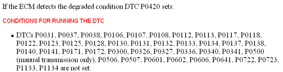

The ignored P0420 could have something to do with the P0171. The P0171 inhibits the P0420 test. The P0420 inhibits several others. Both inhibit closed loop, you have been driving without benefit of the computer programming ever since the P0420 set. So, maybe the P0420 or P0171 is intermittent. Won't know until fixed.
2006 models might need the ECM re-calibrated for both. There is a TSB.
The O2 sensors are designed to vent a tiny bit, if they wear physically they could vent too much.

P0420 for 2 years is deferred maintenance. When there is a P0420 the computer won't go into "closed loop" that means that the engine is running on guesswork not sensor feedback. And other OBD tests don't even run because of it, you don't know what other codes just have not run to fail.
I don't know how the P0171 came to even run and fail except that maybe the P0420 didn't set one time. When the computer is in "open loop" there is no trimming done, so P0171/P0172 are irrelevant.
You have basically been running without the ECM for the last 2 years. I don't know what damage may have been done.
