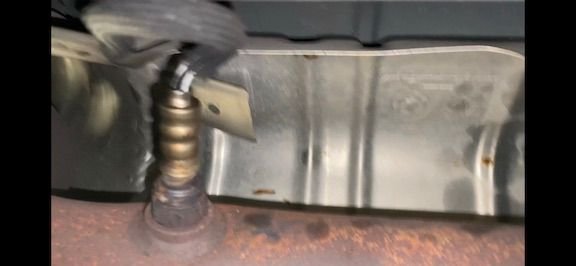

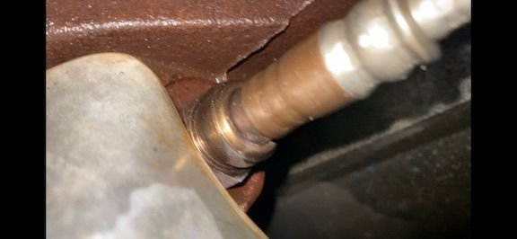

While under the car looking for where the rear O2 sensor is, i was able to follow the wire up behind the heat shield and then can't see where the connector attaches, but i didn't look too hard as i got distracted because what really has me wondering is why ALL the cats i see online - even rockauto under the 2006 2.2 listing all look the same - in that there's the rear plug behind the cat (like mine) and the front O2 plug in front between the flex pipe and the cat (NOT like mine)
The cat on MY car doesn't have the front O2... at least not there. What i think is the front O2 sensor is actually in front of the flex pipe flange. Does anyone else with a 2006 have that set up? I guess it's maybe not a big deal if the new cat can just have a short plug bolt on the front O2 input and swap out the O2 on my car where it's at now?
And yes, i'm not going to bother with keeping the old O2 sensors - so just have to detach the connector on the rear one... It will be a challenge to get the wire fed behind the heat shield if i can't get the car up off the ground enough to work.

The rear sensor wire runs in the heat shield fold , the 2006 had the first O2 sensor in the exhaust manifold

Most of the "fits all" come with a bolt to block the unused bung, use the same sealant as the sensors. You have to unfold the heat shield to get the wire out, then the connector becomes accessible.
The cat gets much hotter that the exhaust manifold, by 1,000 F.
