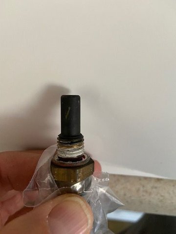

I added in the photo of the scanner showing the alcohol percentage.
sorry but that erased some text above that,
He wrote about how it was fixed, his P0014 code was the exhaust VVT solenoid, he changed it.
the coolant temperature sensor was black , not reading correctly, he replaced that, along with a new thermostat from AC Delco and fresh Dexcool 50/50 mix coolant
coolant temperatures read more stable now.
