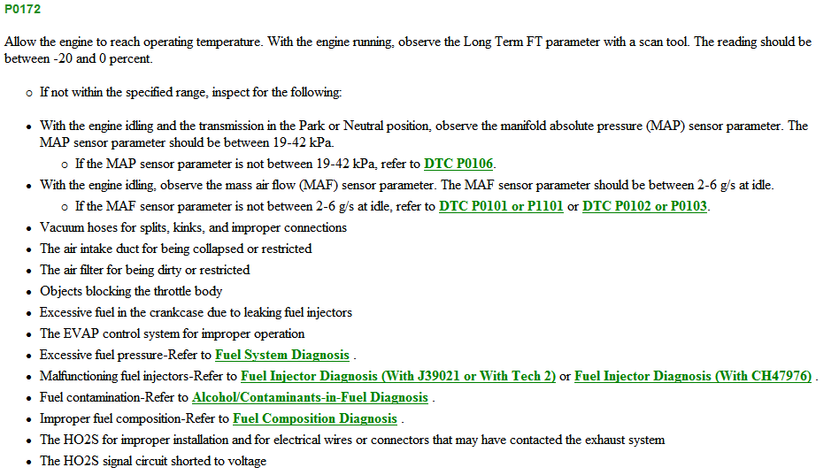

Old Jul 27, 2018 | 08:55 AM
  #30
cturboaddict's Avatar
Joined: 12-10-2010
Posts: 131
From: Collinsville, IL
So, I need a scanner with live data......
