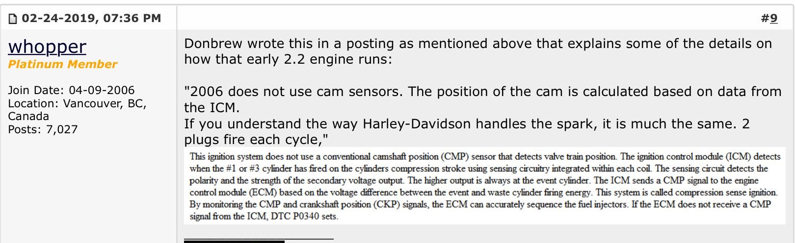

The starter is controlled by the BCM and a relay. The relay is probably bad. Don't hold the key until it start like a 80's car; it only takes a momentary contact to tell the BCM to start the car.
P0340 on a 2006 2.2L means something is wrong with the ICM, either a wire is loose or the ICM is broken.

The starter is most likely a sticky relay. Maybe the BCM gets the turn off signal from the ICM, don't know.

From what I read the signal from the ICM is how it works ‘shrug. Makes sense though if my signal is intermittent. Bad wire would also explain why more pronounced when it warms up. Basically going from an intermittent signal to no signal with expansion.Not sure which wire I should be checking that on as I don’t see a brown and white one as other places have stated.

First thing I’d do is look at the wiring to the crank sensor, but:
https://www.chevyhhr.net/forums/prob...26/#post861336
