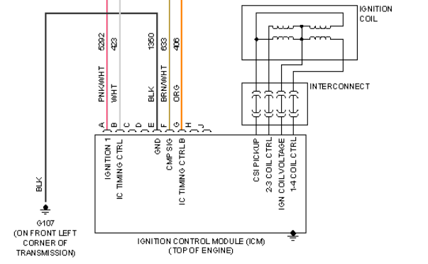

Great suggestions if that was my only issue. However the p0340 code that showed up with it points to a signal issue. Trying to figure out which wire color Carrie’s the firing signal from the ICM to ECM. Which also can cause a 2-3 sec extra starter run on. If anyone knows that wire color off the top of their head I would appreciate it. For a different car it’s a brown and white wire at the ICM. I don’t have one of that color

This is one that I read that has me trying to figure which is the signal wire so I can check it

Solution: check all of the wires. The firing signal is generated in the ICM. The ECM receives a "fired" signal.
I suspect the brn/wht wire is the one to worry about. Did you replace the spark plug boots?

I will check the crank sensor wires today. I put new boots in. Plugs, boots,coil and icm are all new. Thank you for the diagram will check it later as I check others and let you all know what I find.
