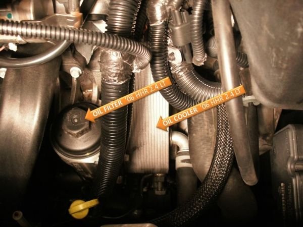

The O-rings on the oil cooler are a common weak point on 2006-2007 2.4L.

Does your 2.4 look like this

no oil cooler on my 07.. I believe it was only an 06 issue
mine doesn't have an oil cooler. that's a common source of leaks. thank god I don't have it.

‘06 and very early ‘07’s had the oil cooler and the 2008 thru 2010 2.0 LNF Turbo engines in the SS’s had them.
So, we’ve eliminated the oil pressure switch, no oil cooler orings to worry about .
