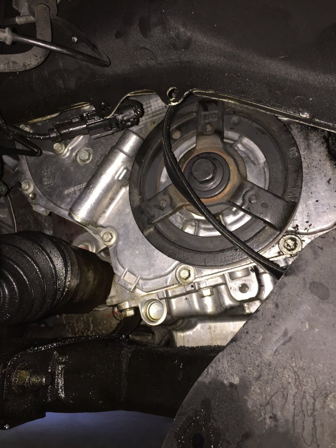

Post a picture of the oil leak
Old Jan 27, 2020 | 05:57 PM
Posts: 40,083
This was an oil leak gone freaky wrong.
Old Jan 27, 2020 | 06:03 PM
Posts: 40,083
This one’s more common and easier to fix , the aftermarket oil seal on the crankshaft shaft balancer was leaking, I replaced with the AC Delco seal from RockAuto

The leaker in the picture was a Felpro

But his leak is at the other end of the engine.
Old Jan 28, 2020 | 07:59 AM
Posts: 40,083
Yes , that is very apparent, CatMan. But see how the oil headed to the front of mine, gravity because I park mine nose down.
