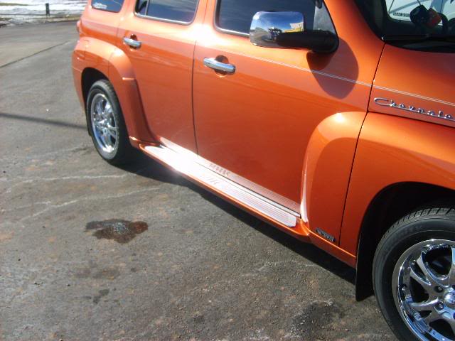

Hi everyone! 1st time i`m here. I`m a newby") I have a 2006 LS that has had no running boards on from new. I just had them installed. I think it finishes the vehicle off perfectly. The problem is that there are plastic patches on the body just ahead of the rear wheel to protect the body from stone chips. They are sand blasted a bit and now that i have the boards on i would like to take these off. Does anyone know how they come off. I think they might be glued on.

I'm sure you're talking about the stone guards...I left mine on for extra protection...but they are held on with double face tape. Just slide some floss behind them and use sawing motion back and forth a little and they should come right off. Then use goo-gone or denatured alcohol to remove the sticky junk left over.
Here's mine with the guards left on.
