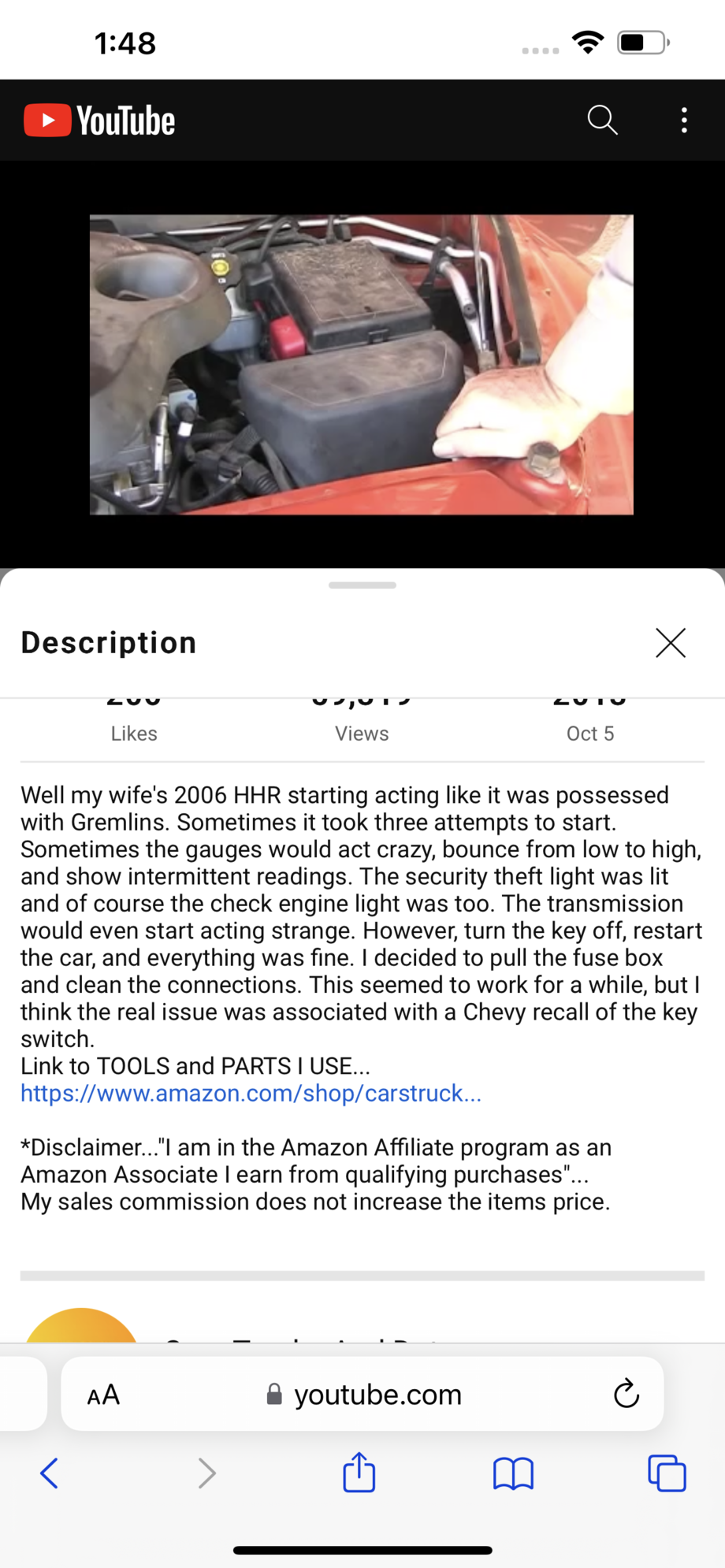

I found this he also says the transmission was acting strange as well. Am going to tighten fuse box bolts before going to work tomorrow. Wish me luck!

Originally Posted by Oldblue
Tighten the 4 bolts in the fuse box.
They are 7 mm
as I suggested in post#14
Old May 4, 2023 | 07:34 AM
  #30
Posts: 26,543
Wasn't that mentioned 2-3 times? I guess youtube is more important.
