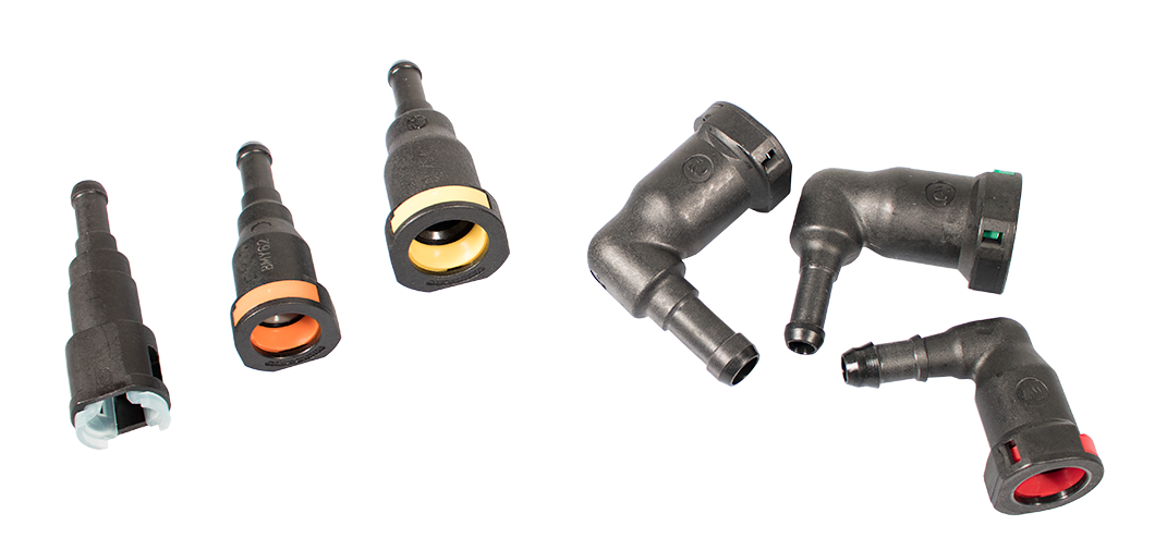

Well I was unsuccessful, I did find a better picture of what it looks like just to be sure the correct fitting is in mind.
It looks just like the yellow one, well more beat up thanks to me. The site describes it as "thumb disconnect" at which point I almost threw the phone lol.

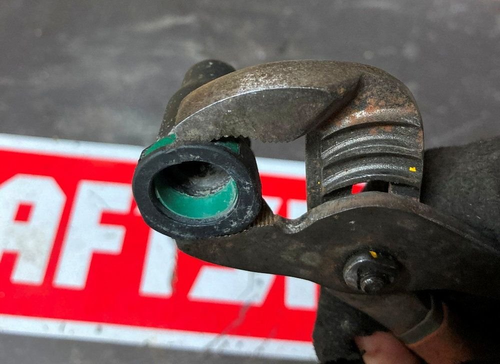

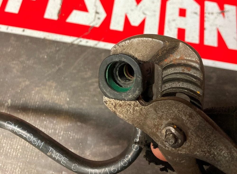

Mine broke the plug on the line to the gas tank. I cant find a replacement line for it anywhere. Is there somewhere I can find a replacement or a patch kit?
The inner part of that connector got stuck to the end of the fuel line. I cant get it off still with it out not that it matters now. You can see in the picture that part of the plug is still connected to the line I took off

Dorman has a kit for nylon fuel lines.
https://www.dormanproducts.com/p-27520-800-300.aspx
Old Aug 14, 2024 | 08:11 AM
Posts: 26,522
My local NAPA store has a book of physical fittings; You take yours in and match it up.
