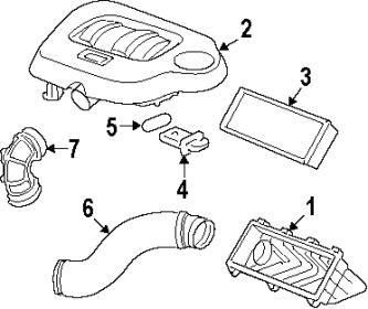

the 32mm (shorty socket) is like $6. at the local auto parts store. (see pic)...
Changing the oil & oil filter is super simple in these engines.
Air filter is only a pain first time, put a bit of hi-temp grease on the rubber grommets & next time it pops off easy.. (see pic)..
You can mentally make it worse that it really is.. Just jump in & do what it needs..

thanks for all the replies everyone. i did my own oil changes on my toyota corolla, mazda b2300 pickup and all, just a little intimidating due to the cramped engine compartment. i think the worst thing they did with the hhr was the air filter housing! that's nuts! never seen one be such a PITA to get open/change! i don't know what the engineers were thinking when they did that one! also, the serpentine belt looks like its going to be tons of fun too, considering there is only like 1" of space to work with!

Leave the torx screw loose, like the GM techs (that I have experienced) do. Remove the motor mount, then a standard loaner belt tool will work, and actually takes less time.
