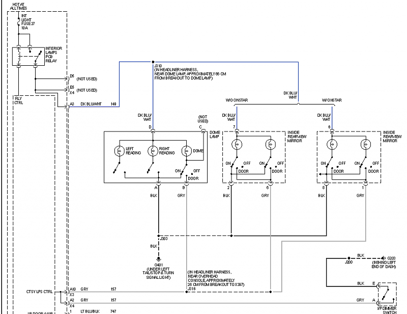

All of the doors switch to ground and the BCM does that dimming by controlling the short to ground on a different circuit, so there are 2 routes to ground. The RAP relay controls the hot side.
The wiring diagram doesn't show the on mirror switch.
So, it almost has to be a door switch.
Is the dome light working, not the reading lights the center bulb? It should be on if the courtesy lights are on, unless it is switched off.

Here is the wiring diagram:
