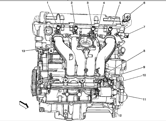

The knock senor is in the same area and the connector may have been "disturbed" whist looking for the leak. True, most shops charge to fix rhings they break.
A thread was recently posted in the how-to area for the oil pressure sensor, a "compleat idiot" could do it in an hour.
https://www.chevyhhr.net/forums/how-...ng-unit-57962/
The knock sensor is #8 the oil pressure sender is #9.
