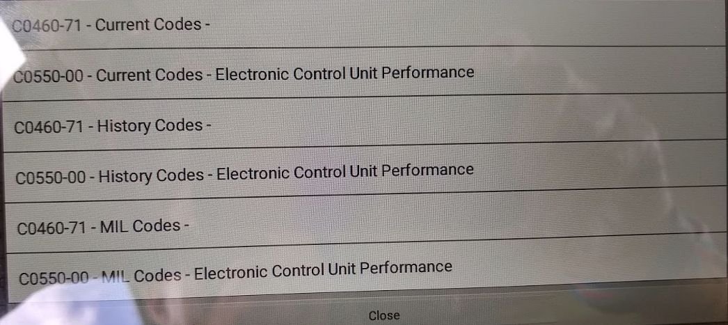

Today I got to use some pretty cool scanning equipment.
Zurich ZR13 scanner.
I pulled several codes from that. One of which was:
Also, an OTC Evolve:
Codes:
P0010-00
C0460-71
C0550-00
Even after clearing the codes, the brake dash light was still lit.
