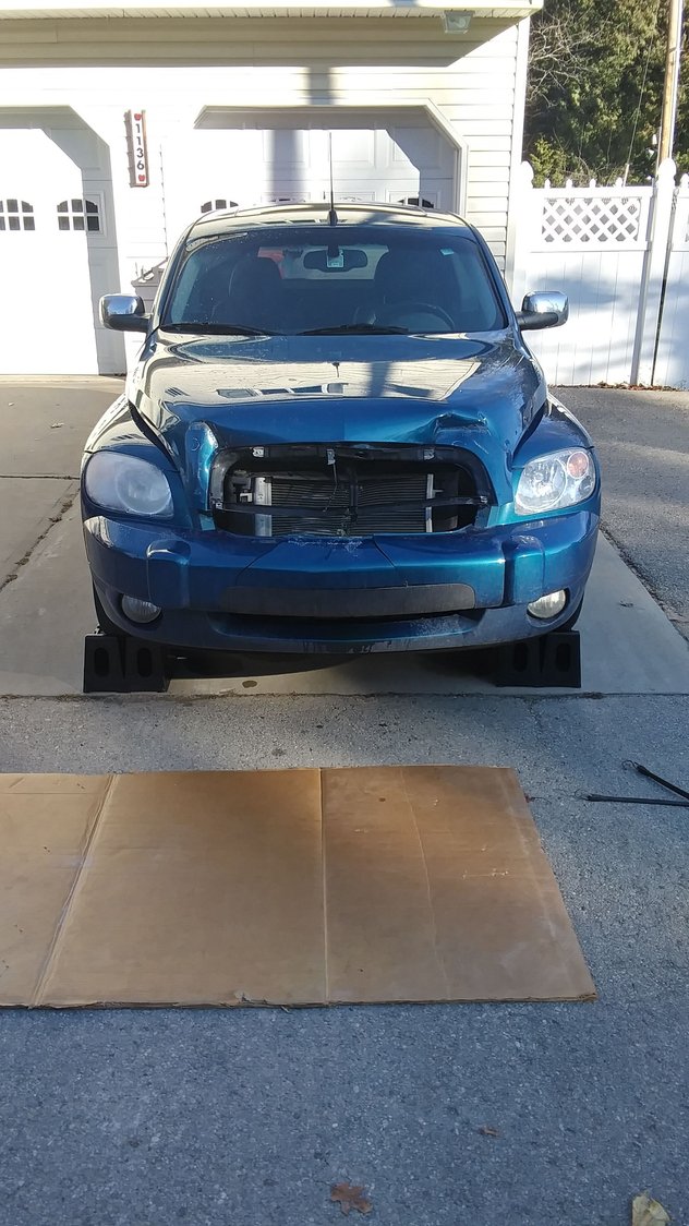

From here it looks easy bolt off bolt on. Bumper cover, hood, grill and AC maybe radiator.
Get the insurance co. or body shop to give you a written estimate then figure what you can do yourself. The estimate will list parts and vendors.
My wild guess is about $3000 most of that is paint.

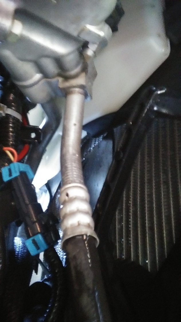

If you can find an HHR in a salvage yard that is the same color, this will save you alot. The google for junkyard parts is Car-Part.com--Used Auto Parts Market You definately need a hood and front bumper cover, maybe a fender and some plastic pieces from the junkyard. Buy the A/C condensor new if it needs it. I know you are trying to show us something in the picture, bu tI just cant quite tell what it is.

Awesome, thanks everyone! The radiator is smashed into the fan, or vice versa... It won't hold any fluid. On rock auto, the parts that could be needed; hood, bumper cover, bumper insert, grill, radiator, upper and lower hoses, fan, coolant recovery tank....i think that's it is like 540 bucks.

I assume that with a high probability is damaged:
Radiator of cooling system - definitely.
Fan - most likely there will be cracks in the fan frame. Also, the headlamp mountings are broken off with a high probability - if so, replacement or action with a soldering iron.
Radiator Support - visible fold in the upper right part.
Filling of the front bumper - destruction is visible through the gap, but you can neglect them, it's just polystyrene.
One can see the lack of fragments on the plastic radiator deflector.
In general, there are many more minor injuries.
Guys are telling the truth. Show your trouble to a specialist.
If you want to assess the amount of damage yourself , remove the front bumper and and headlamps - the scale of the problem will open before your eyes.
