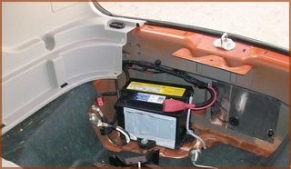

The age of the battery is unknown as I bought the car used earlier this year. But I Did Take Some Photos of it and the fuse as I had a hard time seeing the fuse myself
Edit: So I Finally Found A Wrench to get to the date sticker and it wasn't punched out but the dates range anywhere from Jan 2010 - Dec 2015 Meaning The Battery is anywhere from 5 - 10 years old

That is a very short life battery, only warrantied for 40 months. You perhaps left the key in the on position(maybe to listen to the radio while you worked on it?). Or even left a door open? The interior lights are supposed to turn off after a minute or two, but it doesn't always function properly. Your battery would be dead from any of these.
I'm noticing aftermarket battery terminals and hold down clamp, the terminals could be dirty or corroded, or loose, where the cable enters the terminal, or where the terminal clamps to the battery posts.
The negative cable near the large fuse in your picture looks like it may be damaged? It looks frayed, hard to tell from the angle.

Good eye, Donbrew, that battery could be the problem, I suggest installing a new proper sized battery with new cable ends.

I Will Definitely Clean That Trunk out before replacing anything man does my car look awful compared to yours. Also what should I replace this aftermarket stuff with? could I maybe get some of this stuff from a junkyard I live just down the road from? What Battery Should I Get as I'm looking for a balance of good reliability and a good price.

I like AC Delco, some prefer AGM batteries some like Diehard it’s really your brand loyalty, as for the cable ends , you could just clean up what you have , or get new bolt on clamps like this, most automotive parts palaces have them

That ground lug is awful!! Get a new cable, the mysterious black plastic thing is very important don't disconnect or toss it.
If you think the dead battery has something to do with replacing a taillight bulb check around in that compartment (the panel you removed to get to the light) there is a ground point that may have been disturbed in there.
