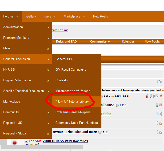

Plus 180 degrees is hard to do with the impact gun, I tried.
Like here?:
