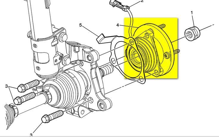

I might be doing something wrong but I can't get #4 and #5 off. I believe the hub is seized in there good.
I am trying to replace this entire thing - this is basically, if not exactly what I bought at autozone. My research is indicating that I'm not supposed to remove the part with the 3 bolts?
The flat smooth gray piece on top with the black ABS clip wire is the part on the old piece that won't come out. Am I supposed to remove all that or not?
Old Dec 18, 2017 | 07:52 AM
Posts: 39,972
You need to remove the 3 bolts, 15 mm and the axle nut, 30 mm for non Turbo .
