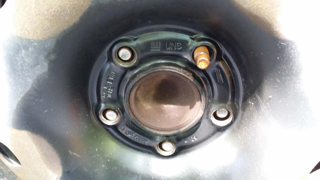

I can attest to the "ease" of replacing a stud or 9. Cordless Milwaukee impact did the deed in a min or so each.
