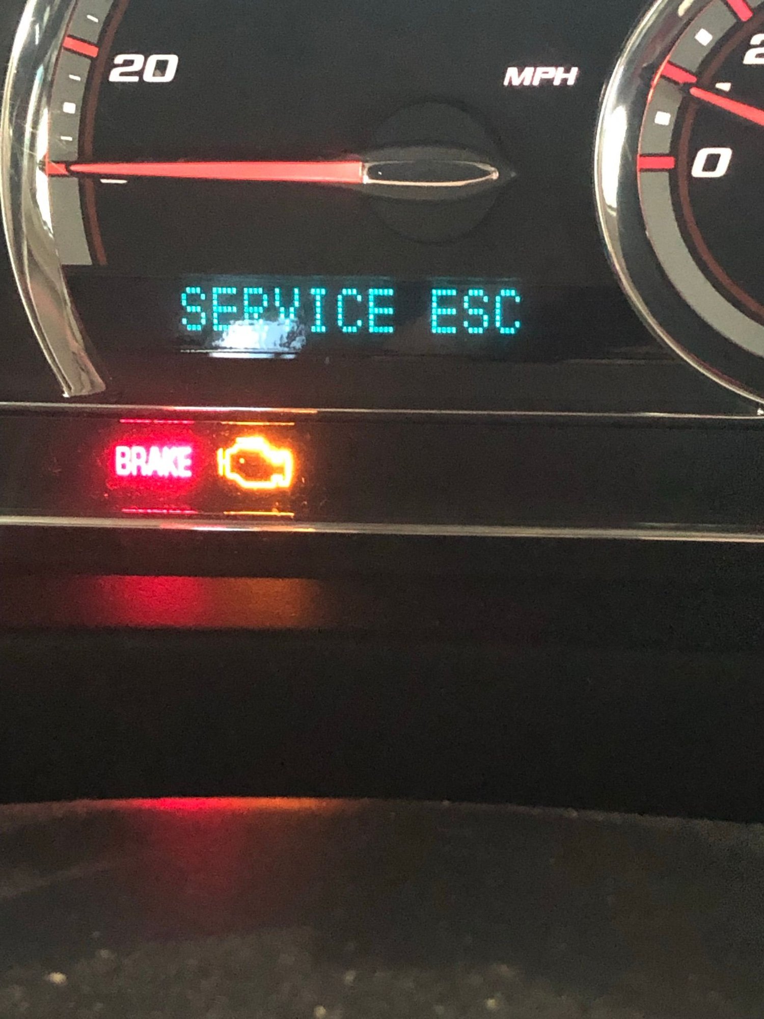

It is going to stay in open loop until the P0030 is fixed. That might be why the ESC message.
I have never heard of the combined "Power Steering ESC" message.

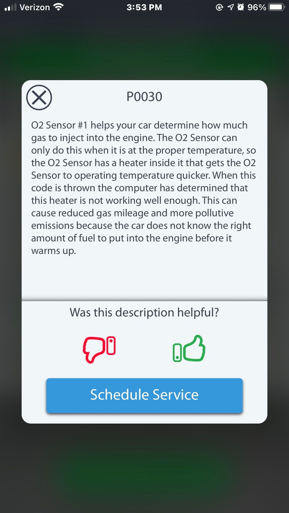

P0030 has nothing to do with the ESC or the power steering. It is a bad circuit to the O2 sensor heaters. ?

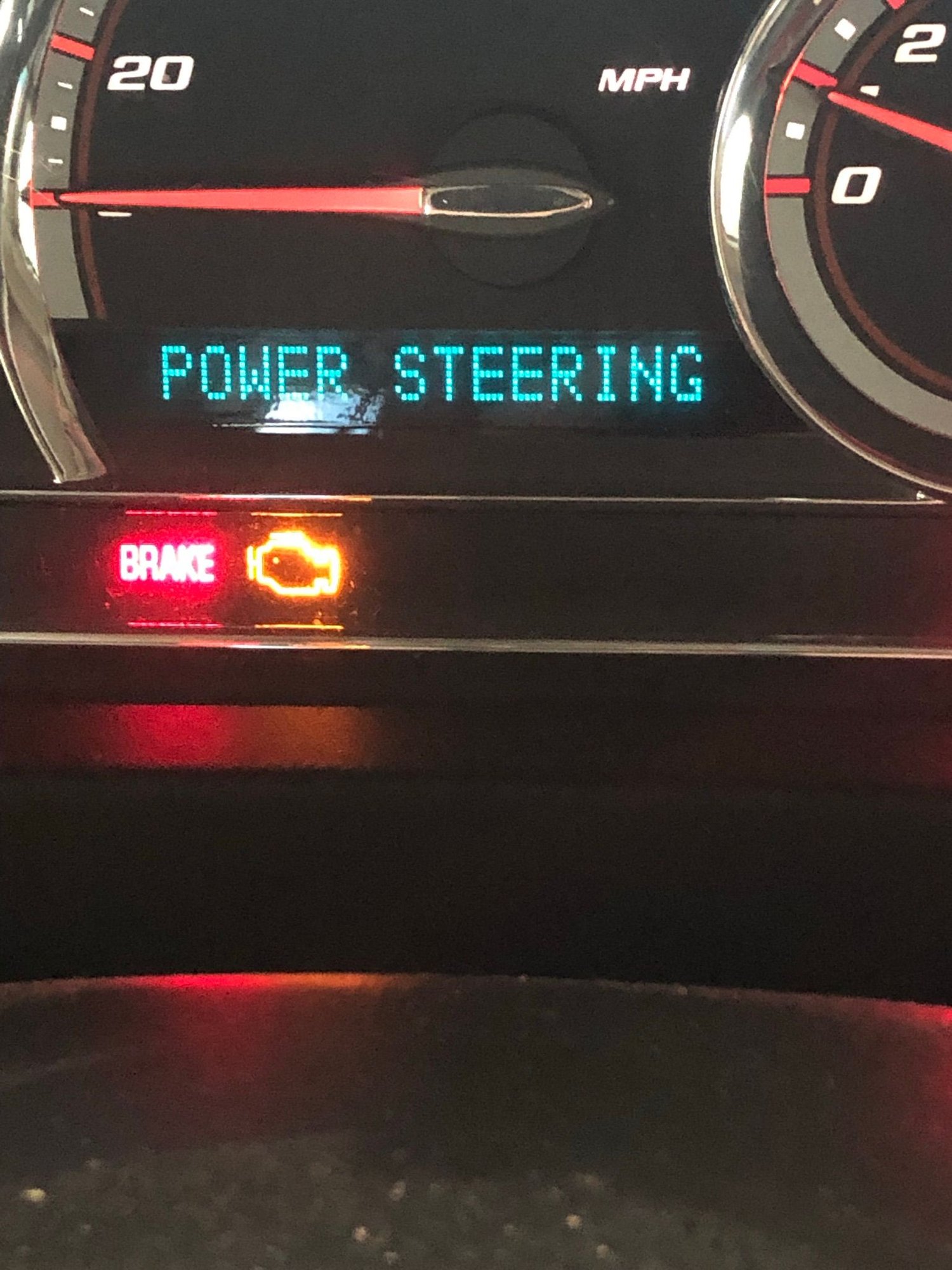

Is that the exact message in the DIC?
yup. That is the exact message.

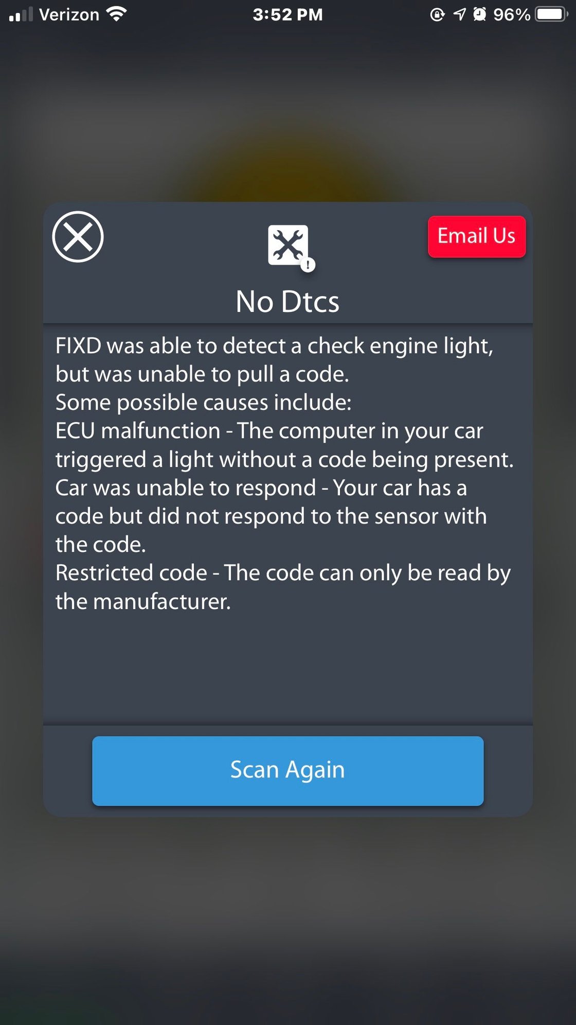

I got it home and plugged in the code scanner. Still code the same code P0030, O2 sensor.

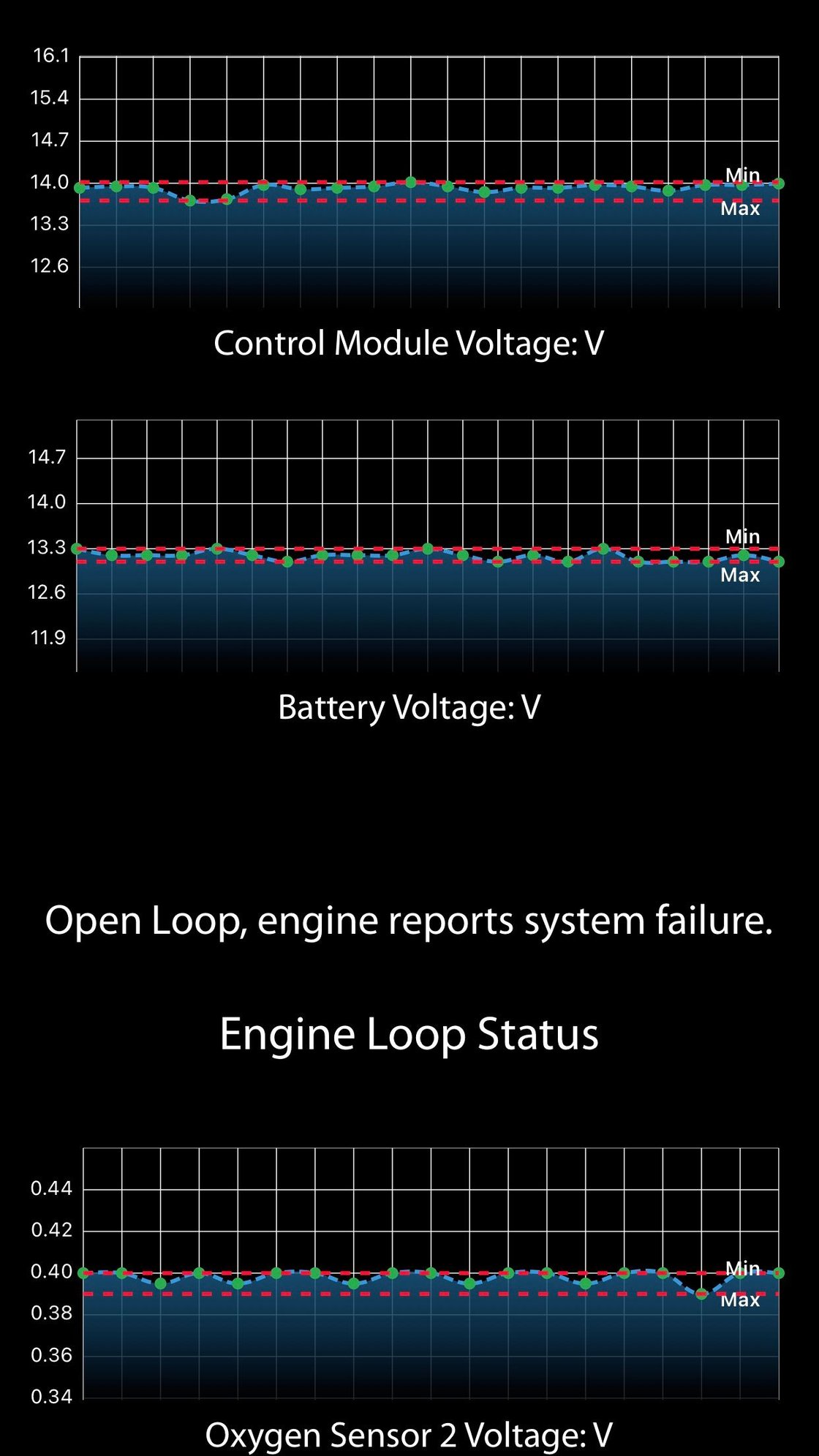

I took screen grabs of the app, as well as the exact message on the dash’s lcd screen, One that I was able to put up a few live readings via that app:

As you can see, lots of the voltage graphs are darn steady, with the only thing sticking out “Open Loop, Engine reports System Failure”
What on earth does that mean?

The readings MUST be dead steady in open loop. Open loop means the computer is using it's own numbers with no feedback from the sensors. If the O2 sensors are not working the computer goes open loop.
The P0030 causes the ESC message because if the engine is not running right you don't need ESC and to alert the unconscious driver that something is wrong.

Where are you finding the code? The screenshots indicate it could not read them.

I was using the car code scanner, and that’s what gave me the P0030 code. I the. Select3d the “clear check engine light” and that’s when it came up (did another scan right after the clear) on the app. The next scan gave me the same P0030 code.

Could be 2 separate problems, fix the O2 sensor then see what happens. Again; it is the O2 sensor heater CIRCUIT.

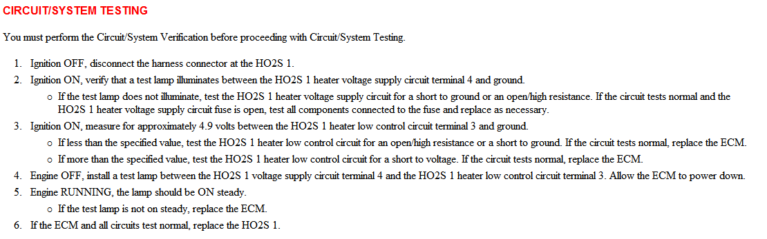

Wow, Donbrew, thats a lot to digest, especially for me, someone who doesnt work on cars. But i do have the gist of it, and will certainly get that O2 sensor issue resolved and see what happens. This week at work is probably going to be insane, so i dont think ill be able to look into this during the week, plus i need to read your reply a few times, just to get my head around it properly.

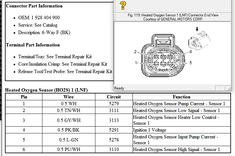

One last question about your reply, when you say "Test Lamp", you are talking about a simple test lamp such as this: https://www.liveabout.com/test-circu...t-light-281976 right? ill have to buy one.
thanks againm
Old Oct 20, 2021 | 07:39 AM
  #29
DeVoiD's Avatar
Joined: 02-26-2020
Posts: 39
From: FL
Is this correct:
"this is a 4-6 wire O2 sensor which means that its a heated sensor. Oxygen sensors are numbered by which bank of cylinders they serve. Bank 1 is the left or drivers side bank of cylinders on the 4.3L which has the odd numbered cylinders 1,3, and 5. Bank 2 is the right or passenger side bank of cylinders numbered 2, 4, and 6. The Bank 1 Sensor 1 would be the sensor for the left hand side of the engine AHEAD of the converter. Bank 1 Sensor 2 is the sensor for the left hand side bank of cylinders BEHIND the converter."
So i just locate the HO2S 1 sensor, disconnect the harness and follow your instructions, right?
Thanks for so much help with this, we both appreciate your time.
