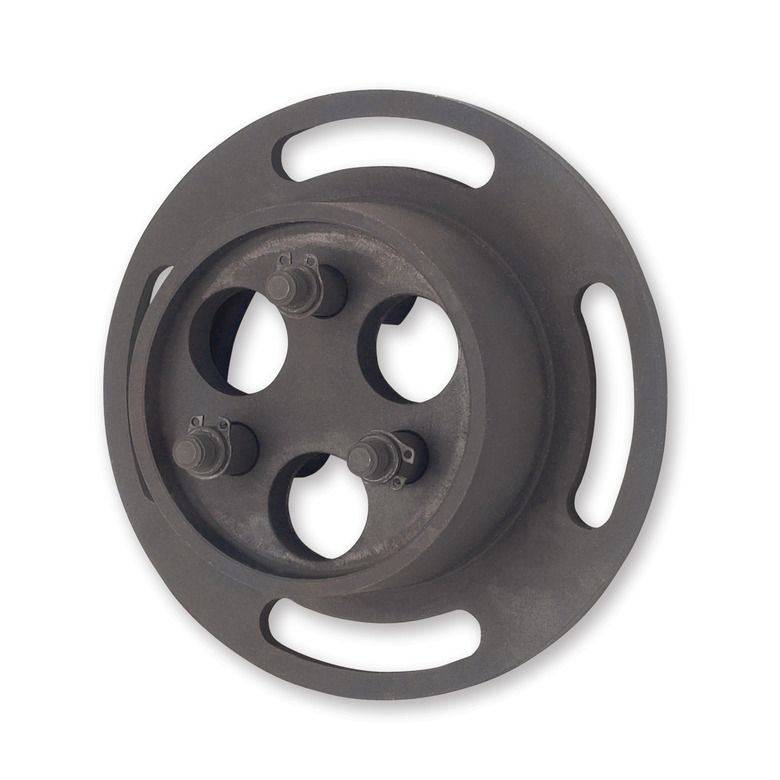

Not long, it’s a pretty easy job , if you aren’t changing the timing and balance shaft chains , you will need the water pump gear holding tool.
This lisle tool , shows how it holds the water pump gear in place , this way the balance shaft chain is held in position, and you don’t have to remove the front cover.

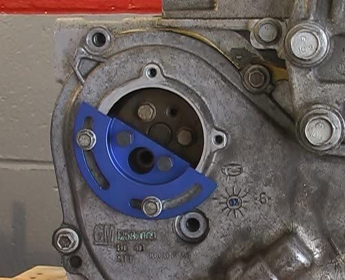

I have this style tool, it eliminated the possibility of dropping bolts into the engine.
This version of the water pump gear tool is fully circle, we are looking at the gear side of the tool.
