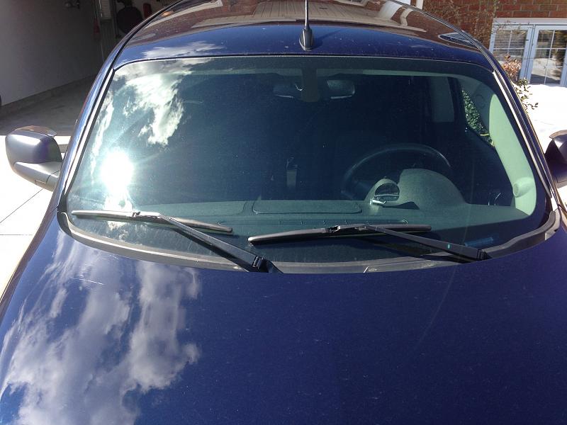

Thinking you folks have misinterpreted the OP's post regarding the windshield wiper arm.
He's talking about when pivoting or folding the arm away from the windshield to change the blade that the arm hits the edge of the hood when raised. Mine does the same thing(arm contacts the hood) because I pivot the arms up every time I wash my car.
I just am extra careful when doing this and haven't chipped my paint there.
Yeah, that could have been designed with a little more clearance in that area.
A little hint: If you open the hood, the drivers side wiper arm can be pivoted to the up position without hitting the hood edge. JUST MAKE SURE to pivot the arm back to the windshield before closing the hood.

Just checked my new windsheild install. They actually rotated the wiper arm a little more than necessary, so it's not even close to contacting the hood. So I know they were paying attention, good shop. I'll reposition it when I get back to California.
OP TheBraveOutside, if rotating does not solve the problem, try swapping left side for right side, the arms ARE different.
I run two drivers side wiper arms, my new windshield has the alignment spots, and my hood was chipped when I bought the HHR.
When I change wipers , I put a shop towel on the hood to prevent further damage.

My drivers side wiper contacted the hood when flipped up when I bought the car new. I had them clock the arm a touch more clockwise so it wouldn't any more.

Adjust your wipers properly, guys.
