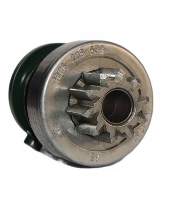

Do you hear a metallic click from the bottom front? If so - This is most likely a bendix - such a self-retractable contraption with a gear at the end.
When you removed the starter, it was probably the last blow to the already almost dead bendix.
How to check: disconnect the starter from the on-board network, connect it directly to the battery - the bendix should move forward and spin. Some immediately remove the starter from the car for this procedure, so that they can be cleaned / repaired immediately after checking. A couple of bolts, no problem.
If it is faulty, then 2 options: 1) buy a new starter; 2) disassemble and service the starter (replacing bearings, replacing electricpullers, cleaning, etc.) + replacing the bendix. If you choose the 2nd option, it is not necessary to do it yourself - there are specialized electrical workshops (at least these should be).
For reference: it happens that the starter is working, but the engine flywheel is already without teeth. But this is hardly your case.

I have already put a completely new starter in the car. I’m convinced it is something else electrical.
