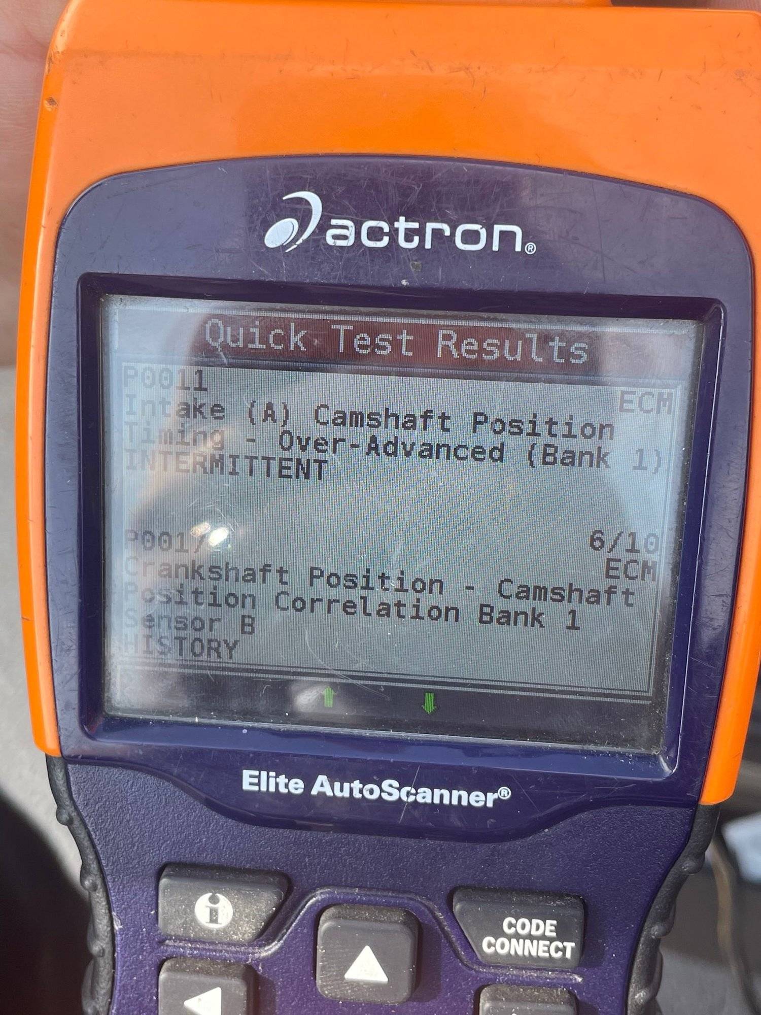

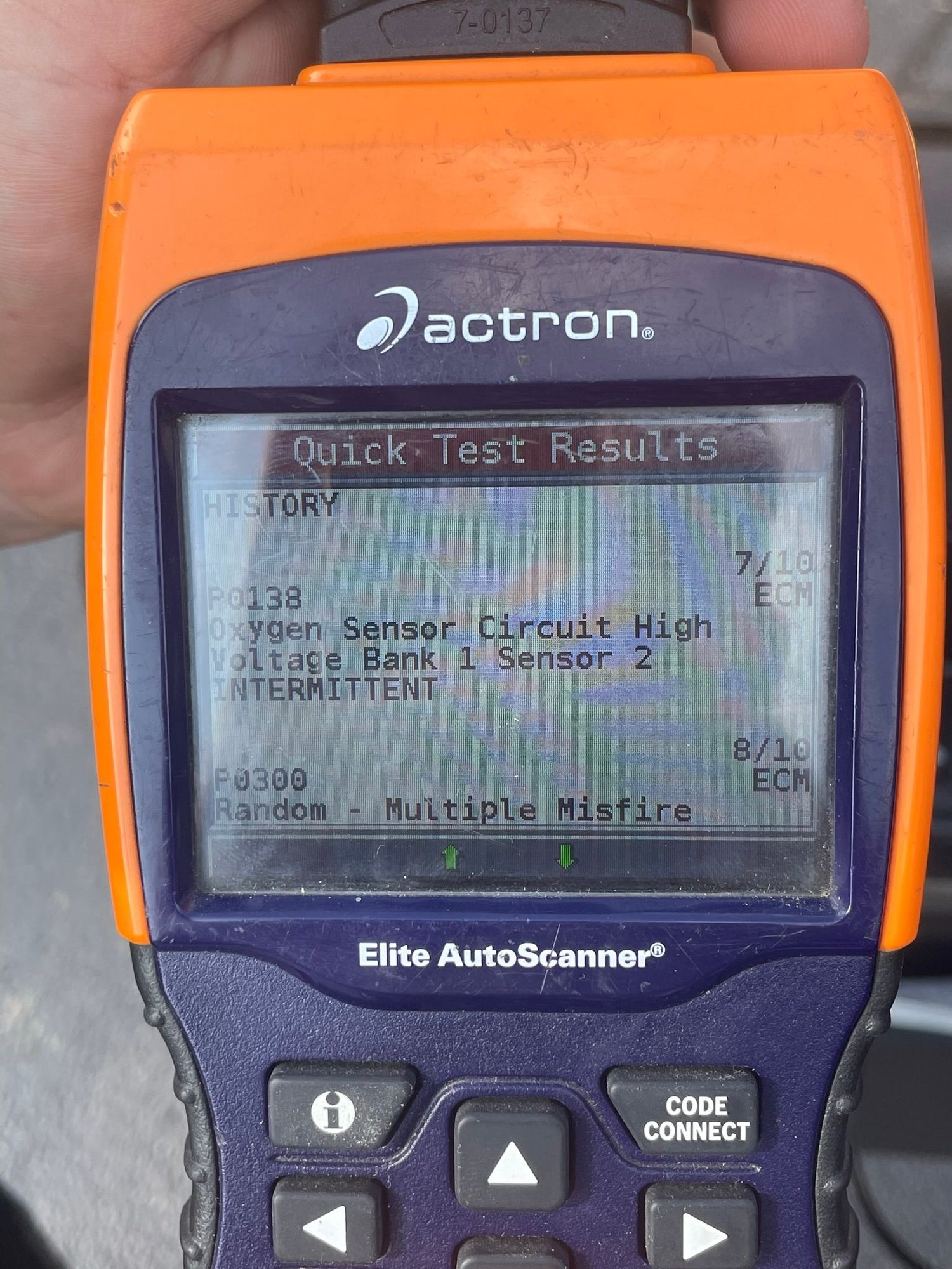

Please, post the codes you pulled.
these were the main codes pulled along with all the random misfire codes as well.
I posted photos of the codes, just waiting for them to be approved by mods.
I should also mention- I’m familiar with the timing chain problems with these engines. This car was actually my father in laws, and he gave it to us because he got himself a new truck. Before he gave the car to us, he had it in to his mechanic because it was running bad - mechanic determined it was timing chains, so he did the timing chain replacement prior to us getting the car. I’ve never had the P0016 code, however I do have P0017, P0011, P0138, P0300, and P0455.
is it possible that the replacement timing chain could have gone bad within less than 6000 miles that it has been driven since the timing chain replacement?

The P0017 indicates something wrong with the timing. First step is to remove the valve cover and see if the chain is tight.

So you ignored the CEL for weeks. You don't know what code or codes were present. Since the P0017 is the problem that can destroy your engine (hopefully it hasn't already), start with that.
Old Sep 22, 2022 | 12:51 PM
Posts: 40,083
Timing chain might be ok but the front guide could have failed , the chain might have jumped a couple of links. Pull the valve cover and inspect it.
