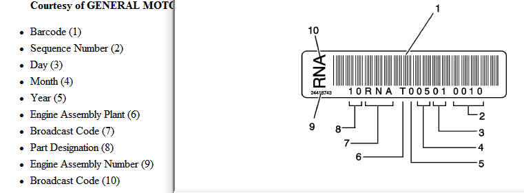

I have been told that it is a "partial VIN" from which the original vehicle can be identified. This is what the dealership told me they used to determine it is a 2.2l engine. And according to the Broadcast label I pictured on the timing chain cover (ACKt808180043) it decodes to a build date of 18th of Aug 2008. I don't know if that is correct but I do know that this engine has VVT solenoids.

Posts: 26,532
The broadcast code decodes as: the last 4 digits (0043) are the partial VIN, the last 4 digits of the VIN, the "T" means the plant the engine was assembled in (Tarrytown, NY), engine built on the 18th Aug. 2008 (2009 model year).
The small numbers are the "Engine Assembly Number". I can't find anything that tells what that means.
Everywhere I look says the number embossed on the oil filter housing is a partial VIN. but it is evidently the engine serial number.
