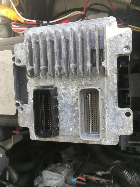

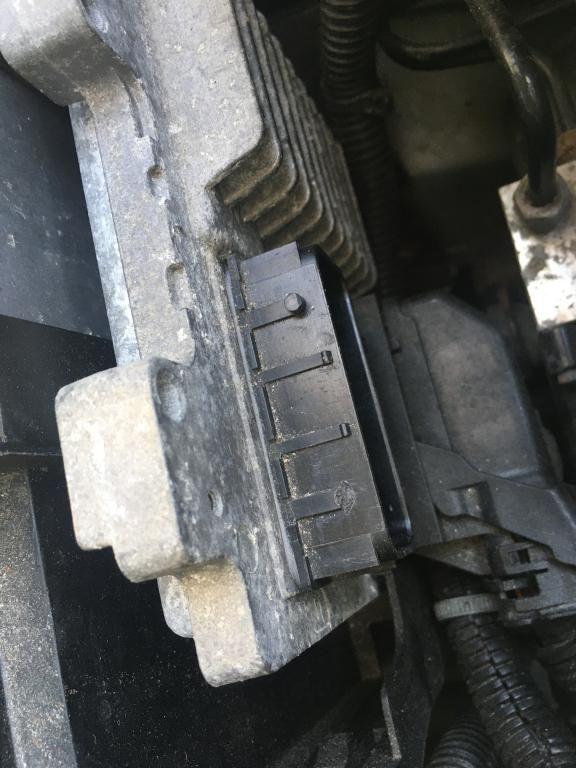

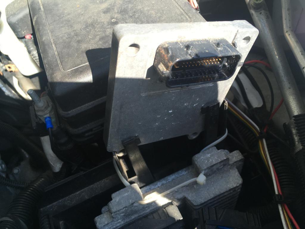

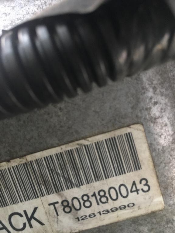

Oldblue: Here are photos of the modules and the label on the timing chain side of the engine. Hope you can tell me something magical based on this! :)
