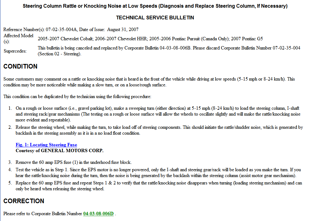

There is a link in my sig to a TSB obout diagnosing noises in the suspension.
And there is this TSB specific to 2006-2007 HHRs. The reference at the end is to the TSB in my sig.

FWIW:
Here is how the GM Service Manager diagnosed my 2010 steering column rattle.
Knowing all the Technical bulletin procedures, he asked me to sit on the front passenger side while the car was in the service dept. bay.
He started the car and set the steering wheel centered straight ahead.
He shut the engine off and paused a moment and then he turned/bounced the steering wheel back and forth to where it hit resistance in each direction.
When he did that we could both hear a very similar noise that I was hearing while driving under certain conditions.
He asked me .. is that the noise your are talking about.
I said YES!!
He never even paused and said no question, the Steering Column needs to be replaced.
He also said if I were you I would replace the intermediate shaft as well.
The bill estimate was $1500 rounded which also included an alignment.
