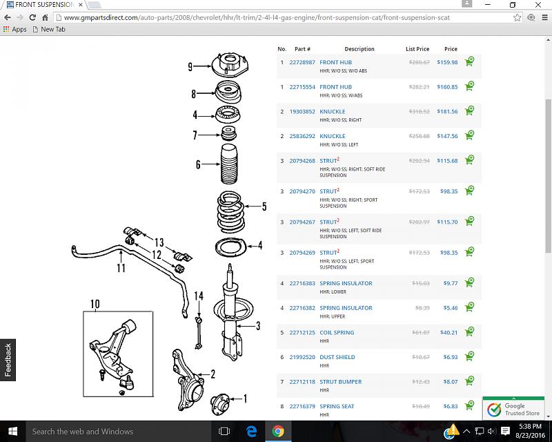

Have you tried any of the GM online stores ? Don't seem to be that hard to find.
A little bit pricey, but at least they show the part #.

Thanks Guys. I looked up the part at gmpartsdirect.com but couldn't locate it at RockAuto. I'm going to bring home a 16mm socket from work tomorrow to attempt to tighten it up. If that doesn't work, I'll be ordering the part.
