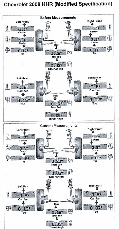

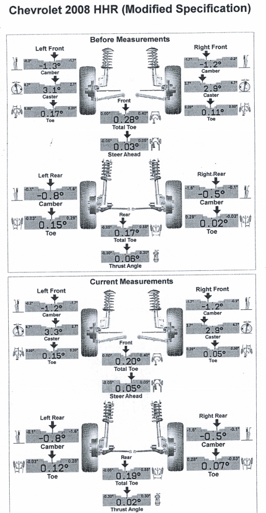

Well, $95 later and it's supposed to be in spec again. They did a 2 wheel alignment. I have not been able to talk to the tech, so don't know if those aftermarket struts had the elongated holes or not. I don't remember seeing them when I installed the struts, but also wasn't looking for them. I just recall everyone saying that OEM HHRs don't have adjustable camber.
Next week I buy the new tires.

I can't figure how my tire wore so badly with these numbers.

A. If the control arm bushings are bad the angles would change constantly
B. Worn out hub/bearings will cause odd wear, usually either inside wear and/or cupping, much like camber
I am wondering why the tech bothered changing the toe, if he was going to leave it "not perfect". As far as I can see there is no improvement. It started out within limits ended up still within limits, but still not optimum. In fact, it was better before than after.
