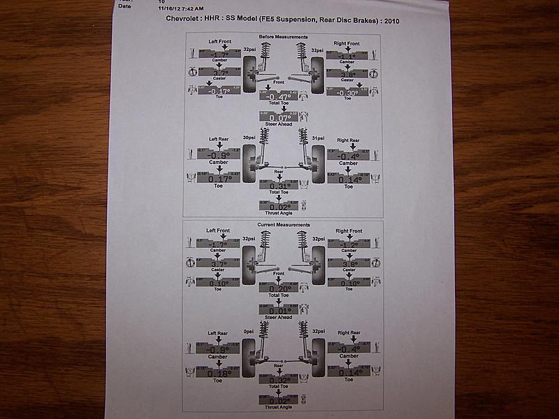

I'm with Don. Not sure why the alignment guys left your toe "off" as much as they did.
Here's the alignment done on mine after my lowering springs were installed.
(SS FE5 does have some different specs )

B. Worn out hub/bearings will cause odd wear, usually either inside wear and/or cupping, much like camber
I am wondering why the tech bothered changing the toe, if he was going to leave it "not perfect". As far as I can see there is no improvement. It started out within limits ended up still within limits, but still not optimum. In fact, it was better before than after.
