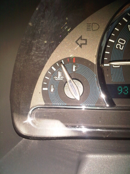

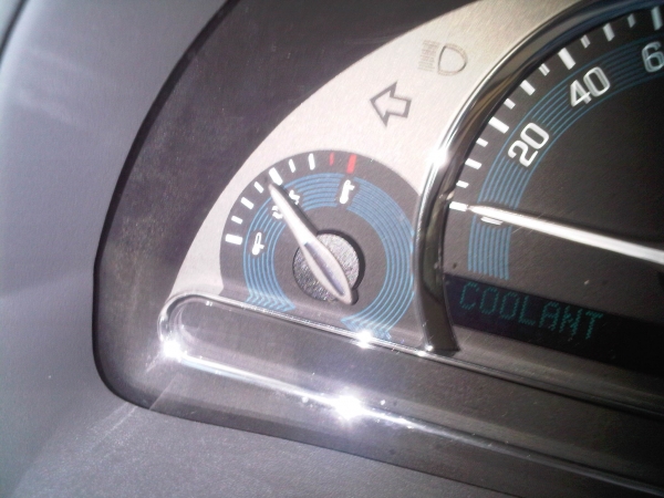

Warm reading (after adding water)

Hot reading ( at my parking lot iddling)

Teh gauge readings where before adding the water 226 - 235 after adding the water 196 - 206... from the ones that I could read...

196 to 206 is in the normal range.
Looks like you were low on coolant.
Pay attention on how to check that (marks on coolant overflow tank and documented in the owner manual).
