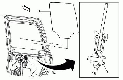

Let's try this again.
Preliminary Procedures
1. Remove the interior trim panel. Refer to Rear Side Door Trim Panel Replacement .
2. Remove the water deflector. Refer to Rear Side Door Water Deflector Replacement .
3. Remove the rear side door window inner sealing strip. Refer to Rear Side Door Window Inner Sealing Strip Replacement .
4. Remove the rear side door window outer sealing strip. Refer to Rear Side Door Window Outer Sealing Strip Replacement .
1 Rear Side Door Window Bolt (Qty: 2)
Notice: Refer to Fastener Notice .
Tip
Loosen the bolts enough to let the window glass move free from the window regulator clamp.
Tighten
10 N·m (89 lb in)
2 Rear Side Door Window

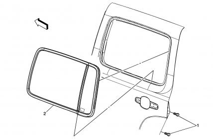

Remove the rear door window. (see above)
1 Rear Side Door Window Outer Sealing Strip Screws (Qty:2)
Tighten
10 N·m (89 lb in)
2 Rear Side Door Window Outer Sealing Strip
Tip
1. Pull the rear window stationary seal from the pinch weld flanges.
2. Lubricate the rear window stationary seal to install.
3. The rear door stationary window is part of the rear side door window outer sealing strip assembly.

Looks clear for me now ChevyMgr! I think that I Should just follow the procedure above, not sure if I need to remove the moving glass from the first image. I just require to replace the door stationary window included on the outer strip assembly.
Thanks a lot ChevyMgr!!
Old Aug 29, 2012 | 10:10 AM
Zagohhr's Avatar
Joined: 06-18-2009
Posts: 856
From: Monterrey, México
Glass replaced. Piece of cake, just took me five minutes. Thanks ChevyMgr for your guidance!
