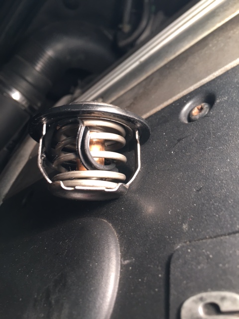

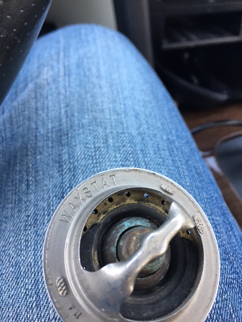

Through some research I found out that my vehicle 2006 Saab 9-3 is a "GM" vehicle, and I eventually ended up here at this site and found some very important information about the "cowpie" theromstat. I wish I had known about this situation the first time I replaced my theromostat with some "Autozone recommended OEM ( P.O.S.) " THANK YOU for recommending the ACDelco ( GM made ) 131-158 thermostat. I just bought one and installed it which was now the second time within a year I had to replace my thermostat. Hopefully this will now permanently solve the problem. I wanted to show you what I experienced. This first pic is my original oem thermostat that failed
Replaced the failed original thermostat with "oem" replacement from Autozone and within a year it failed causing P0116 error code and looked like this when I pulled it out
Thanks ALL for directing me to the actual correct thermostat. I am hoping it will now STAY fixed.

I can't say it enough! Get the right parts!! We've learned the hard way, and pass our experience on to save y'all time and money!
It amazes me that still people want to buy the Stant or the MotoRad T-Stat just to save a few bucks!
Glad our site could help out an Ecotec derivative owner!!
