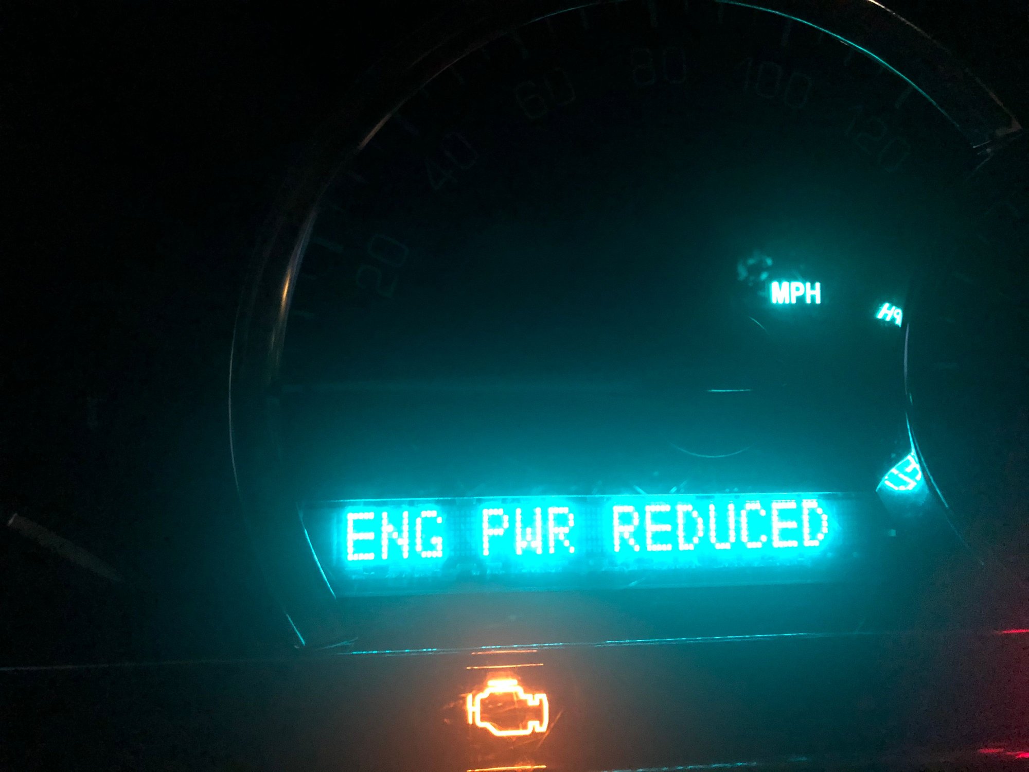

The Saturn drives amazingly better. Smooth and much more responsive and warmup low idle is faster. However, after driving the HHR around the block, I get these 3 Codes thrown... I’m totally confused about them. There were no codes before.
Lastly, the Ugly is this ...

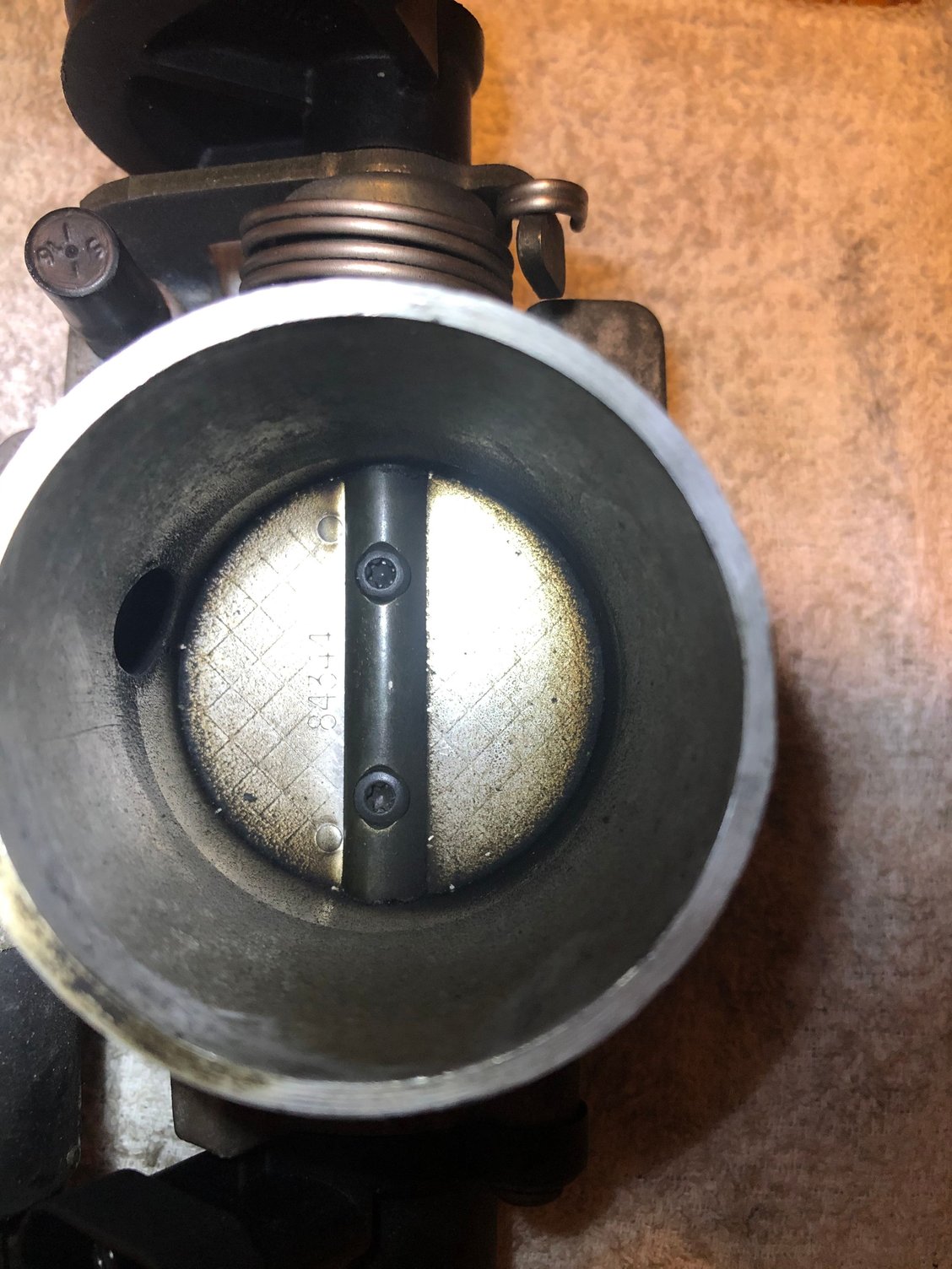

HHR (Motor Side) After
This is why, you cannot move the butterfly plate. Now you need to buy a new throttle body.
Old Mar 23, 2020 | 06:05 AM
Posts: 39,978
X2 the throttle body has wee tiny plastic gears, you should never move the butterfly plate manually, that might strip those gears.
this might clear up , try a battery lobotomy, but plan on a new throttle body.
Old Mar 23, 2020 | 07:38 AM
Posts: 26,481
Maybe not. Make sure everything got plugged back in with no damaged pins. Make sure the butterfly is fully closed engine off. With key OFF make sure the butterfly moves and returns. Make sure the intake neck is tight.
The gears stripping comes from the grease getting dry; a 2010 shouldn't have that problem. It is forcing the butterfly that causes it, it should move with little effort.
The message on the DIC is from the throttle sensor error.

P0172 dirty MAF sensor
https://www.obd-codes.com/p0172
P0223 yes pins, damaged throttle actuator
https://www.obd-codes.com/p0223
P0442 , loose gas cap or EVAP seals
https://www.obd-codes.com/p0442
This is very interesting that you said "Fully Closed with Engine Off". I noticed that it was not fully closed when I pulled the air tube before I touched it, just looking at it from above. It seemed to have a slight opening at the top. I never touched it while it was plugged in, and when I cleaned it, I just slowly moved the butterfly to clean where it was sitting until it was clean (like in the pic), then I moved it back. It never seemed forced, and I didn't hear any clicking or slipping, It seemed to return to exactly the same position when I released it. I know the calibration on those things aren't made to force, so I never did anything to force it, but that air gap was a little surprising to me when I first saw it. I know my Saturn's is also flat and no air gap, and looked quite different. I need to research why this is.

Thank you for looking these up.. I had the first and third codes before, and since everything was still original, I went ahead and replaced the MAF plus I Got a new levelled up Gas Cap from Napa (OEM compatible), and the two codes went away. Then after cleaning the Throttle Body, that's when these came back. It's really odd to me, because the parts were replaced and codes went away 300+ miles ago. That's why I was thinking to take your advice to disconnect the battery for a while and see how it goes first. As far as the pins, I'm going to go out and see how they look under the microscope. Let's see how it goes.... THANKS MUCHLY!
