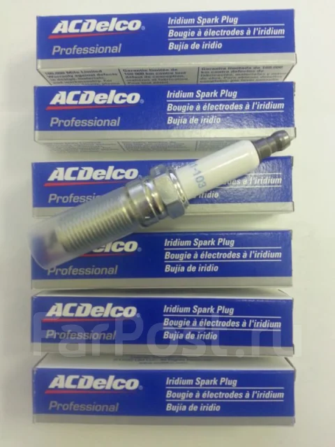

This flutting rev sound/ tic at idle turned out to be a broken whisker on the #3 spark plug, which I discovered a couple months after posting this video.

I never heard the term spark plug "whisker" before. Can you explain?

He's referring to the center electrode, quite small on these iridium plugs.

It's small but zaps a whole lot of voltage!! That's why we highly recommend to never touch it with a gapping tool

How are these type of spark plugs gapped? I am used to the traditional wire gap gage that would require some electrode contact.

They are gapped at the factory and shipped with protective sleeves.

Yes. I never touched or attempted to change the gap, but somehow it broke off anyway. The whisker is that hook looking part. I think that spark plug had a hard time during shipping; the replacements have been perfect. Anyway, that same issue caused an odd foghorn/clown horn phenomenon through the EVAP system, that was rectified when I replaced the bad plug. Amazingly, the car ran, revved, and performed perfectly with the bad plug in there. These engines are amazing.
