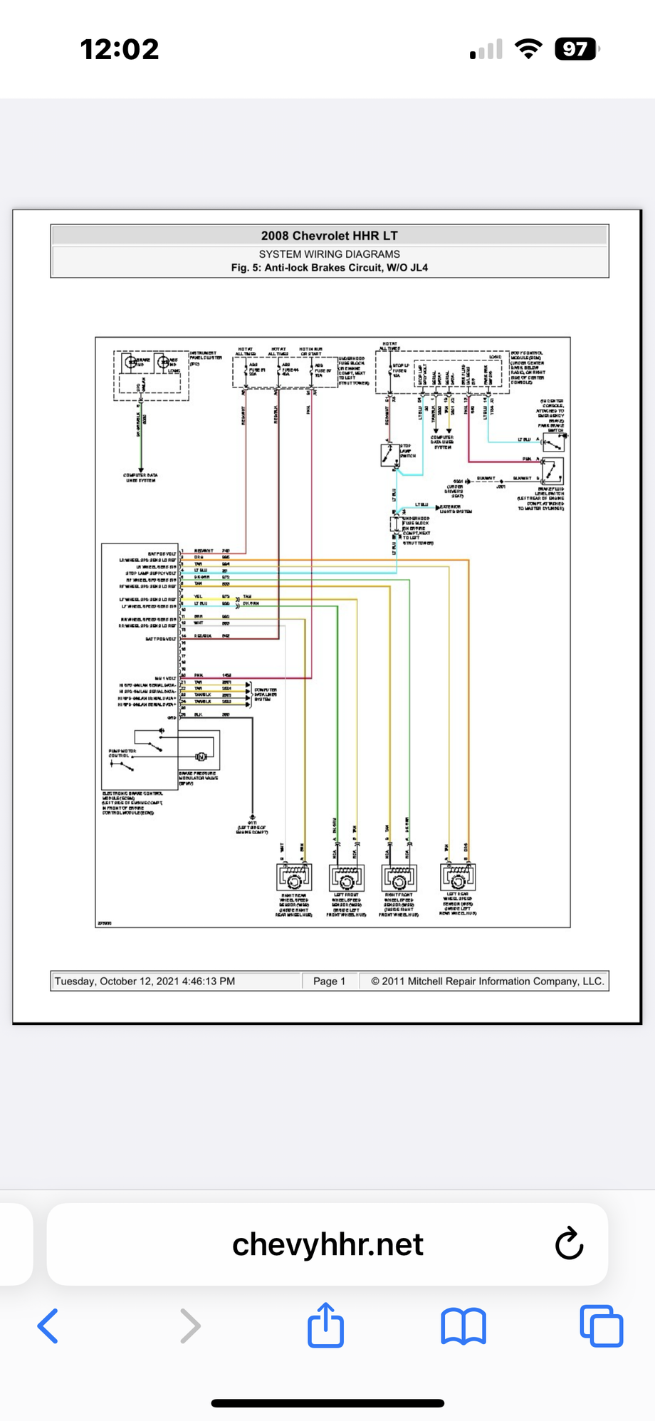

You don't happen to have the pinout on the plug to the ABS computer so I can check the voltage?
Old Nov 2, 2025 | 11:03 AM
Posts: 40,083
Hope this helps
Hope this helps
