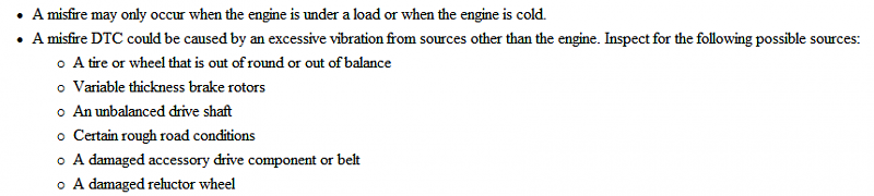

I am taking a wild leap and suggesting an occasional misfire. As long as the error exists the Traction light will be on. But it may take a second instance to set the CEL.
Misfire codes are type B:
Type B
Emissions related.
Sets a Pending Trouble Code after one failed driving cycle.
Clears a Pending Trouble Code after one successful driving cycle.
Turns on the MIL after two consecutive failed driving cycles.
Stores a freeze frame after two consecutive failed driving cycles.
I just read this; might explain some of the unexplained P03xx codes:
Type B
Emissions related.

There should be a stored code, but it will go away after the next start with no error. Plug it in while the CEL is on. Expensive code readers can read the TCM and the EBCM and the BCM.
Type B
Emissions related.
Type B
Emissions related.
