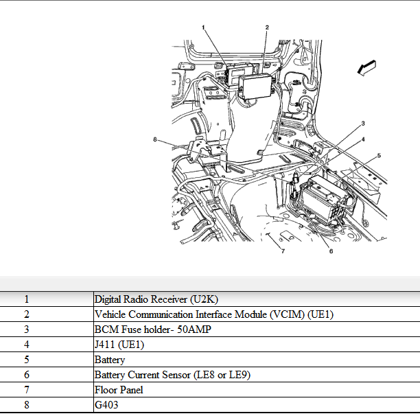

Looking for pics or instructions on how and where the vcim module is located on car and what is needed to get it to work thanks
Old Nov 1, 2020 | 03:33 PM
Posts: 26,533
It is behind the quarter trim panel above the battery. A few members have done it and described their experience somewhere on the site. It is evidently a unplug the old plug in the new job. The BT is independent of OnStar; you don't need to pay anyone. I don't recall if the VCIM has to be out of an HHR or not.
Be sure to disconnect the negative post of the battery, OnStar can do things to the car if it gets damaged.
